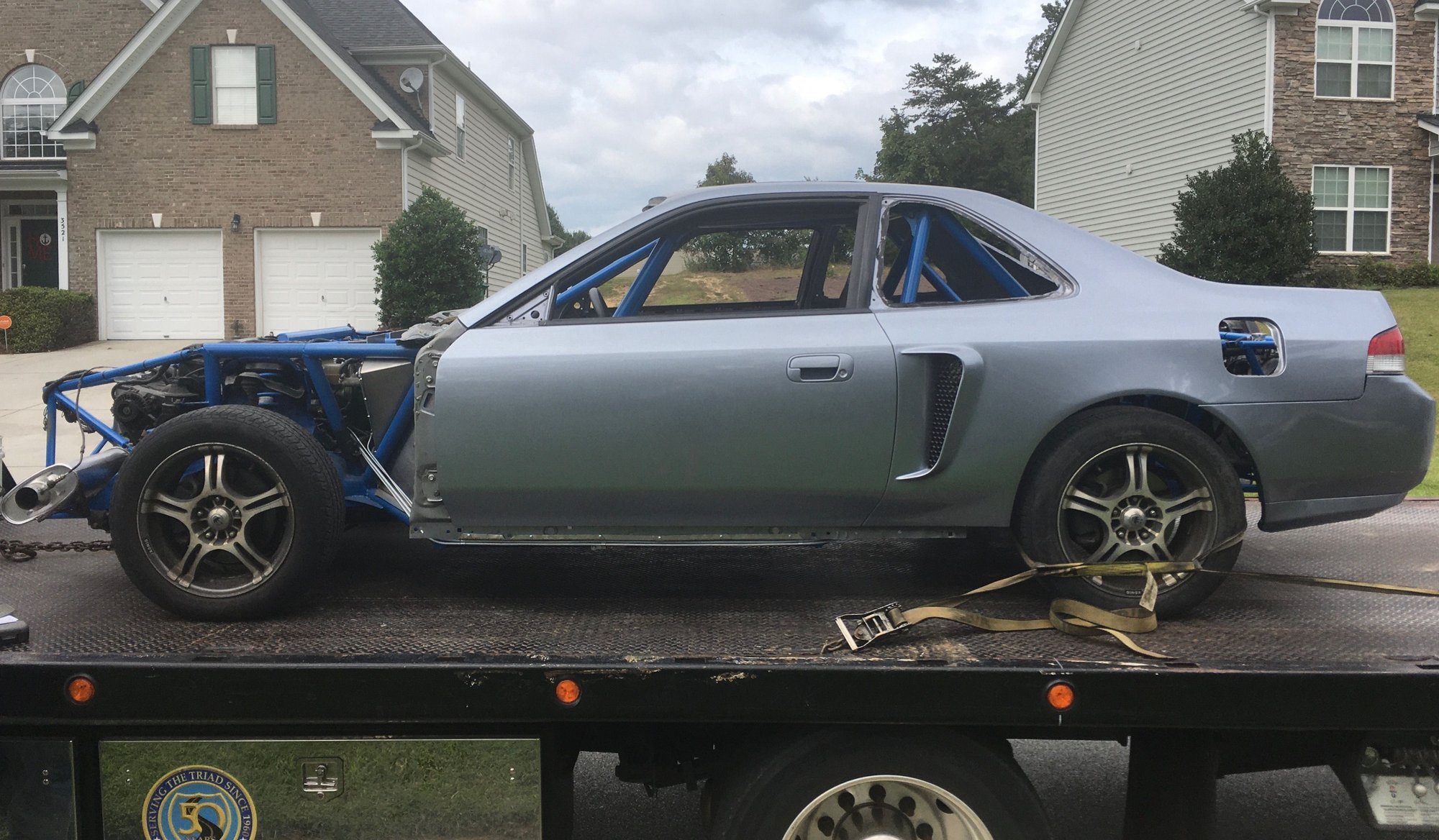

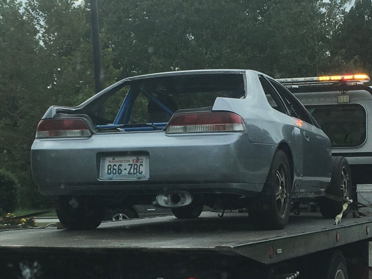

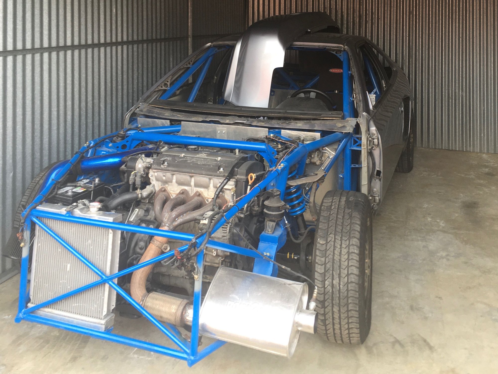

There are two transmissions in the car and both are M2Y4, sadly both have what seems like worn 1st and 2nd gears. Don't grind going into gear but when under load pops out of gear. Anyone have ideas on how to repair? I've looked for replacement gear sets and collars for at least 1st and second and was not able to find anything new. Any help is appreciated.

Popping out of gear suggests the transmissions have been run without fluid for a while now... OR your shift linkage is so rigid that the engine movement under load is yanking the transmissions out of gear.
Just an observation: Your front engine will NOT run correctly in closed loop with the O2 sensor mounted at the muffler tip... too much oxygen from the outside to corrupt the readings... your adaptation will be CRAZY. Move it to collector pipe in the header (between the 4-1 junction and the flex pipe).

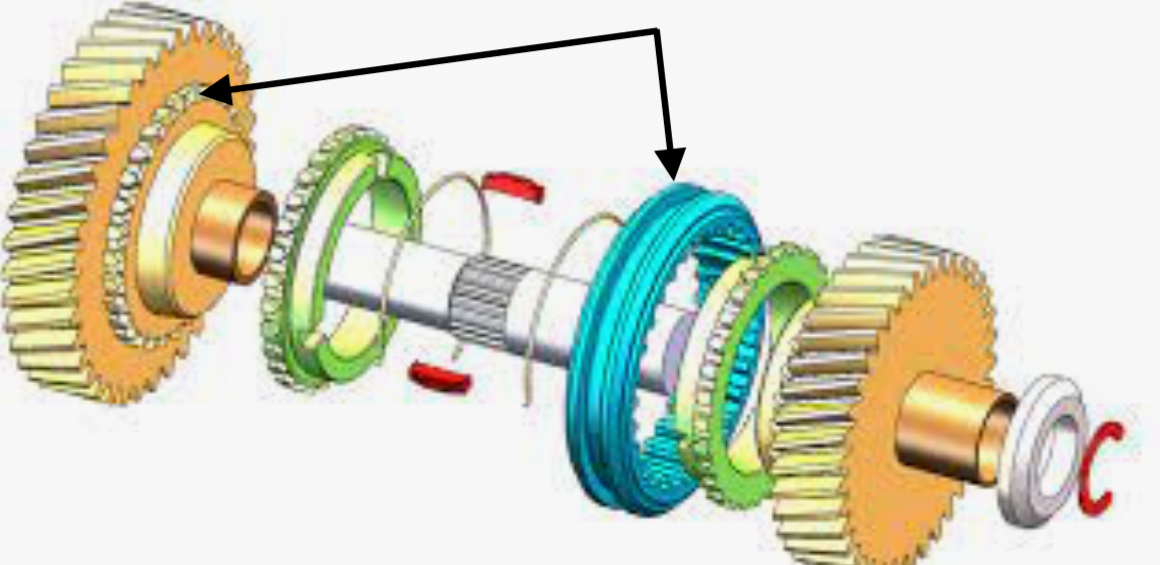

Thanks for your reply! I've got enough brand new Honda fluid in the transmissions now, but who knows what the previous owner did with it, so excellent point! Next time I'm in storage, I will check the linkage movement by looking at the arm on the trans while under load to see if there is movement, if there's none I guess it means the little dog gears are worn inside? Since a new shift collar has engagement gears at a slight inward angle to pull the gears together but in my case they might be worn, which I didn't pay too close attention to when I had the trans apart.
Great point about the O2 sensor! What you're seeing is actually the downstream sensor with a modified spark plug defouler with a 1/16" diameter hole to trick the stock OBDII in thinking there is a catalytic converter. The upstream O2, the one that is used for AF ratio is just before the muffler, but it's behind the pipe so you can't see it in my photos. I have this trick on both engines done and they work flawlessly with no engine codes.

Thank you so much for your feedback and the links! I remember putting the detent springs back in and didn't consider them as the culprit since my understanding was that they are there to help keep it in gear but the main keeping together force was due to the slight angle in the mating engagement gears and collar but it's definitely worth replacing those since they are cheap and easy to put in!
