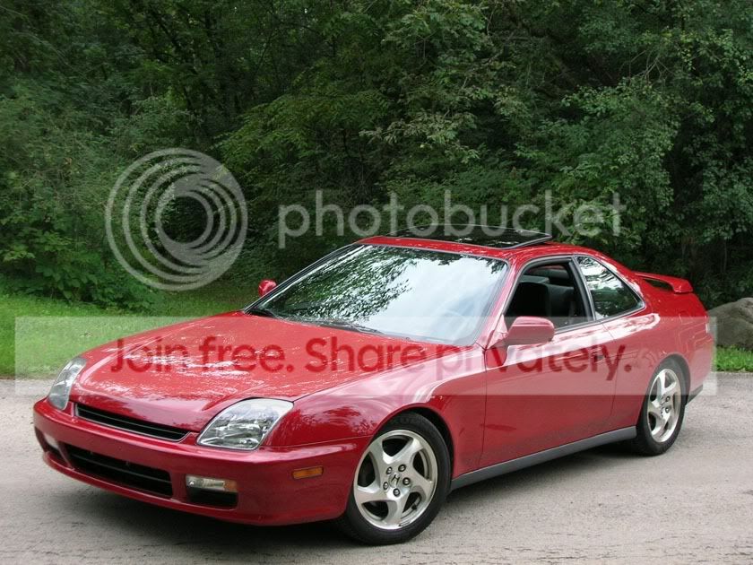

I only replaced my struts with the koni's and used the lower mount. It lowered my car about .75", and it rides better then stock.
Personally my car is on the line of being too low for daily driving, but that truly depends on where you drive, and how good of a driver you are. I can get tons of places that would cause alot of cars to bottom out, but when you have softer springs, and then hit a bump at speed it does tend to scrape.
Just a thought. Heres a pic too:
sorry for the MASSIVE image.

^^ That is a good hight with that wheel tire package. I only dropped mine about 1'' and i am very happy with it. I am runnin 17s for now though. I am lookin to go to a 16 real soon.
