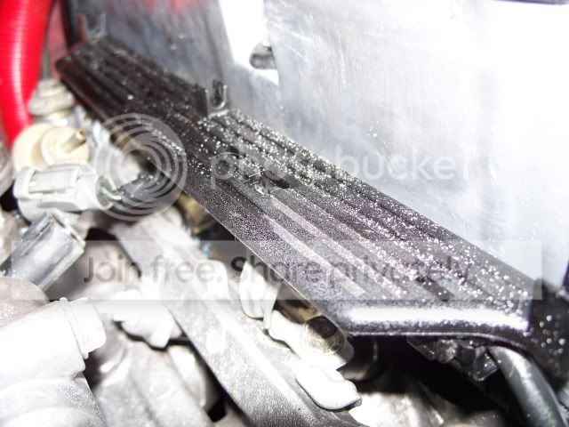

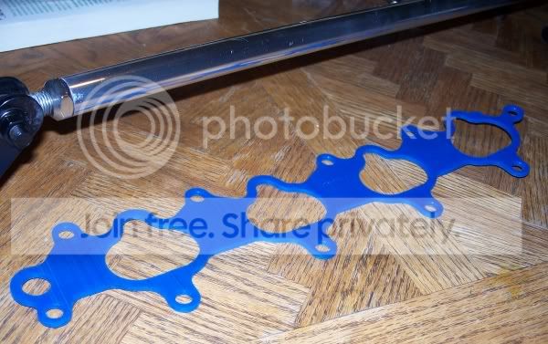

some of you guys know that I have been thinking about removing my egr valve for a while now. I started doing so today...
took off valve...
and look what I found (the one on the right duhhh)
this makes me very happy because I allready passed emissions with the egr blocked off and didn't even know it lol. The previous owned did a lot of half-*** things to the car but this is the first well done thing that I have discovered thus far

and my question is how do I get this stupid plastic injector cover thingy off? I dont want to yank on it and crack it, I've done that with too many other timgs on my car
thanks guys
Old Feb 19, 2007 | 01:49 PM
BB2H22's Avatar
Posts: 242
From: North Little Rock, AR, USA
Those little slitts in the top have a plastic snap. reach in there with a knife or small flat head and push it ot the other side and pull a little bit. Do it for each one until it comes off.

fingernail FTW

k, thank you
