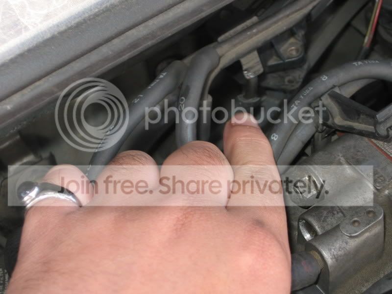

check your knock sensor, and also the vac line running to the map sensor, where it connects to the hard line, im gonna attatch a pic in a sec.
edit: excuse the hairy knuckles but its the one im pointing at...right on the firewall that one always **** up.

haha um the h22 is in an eg civic so the vac line isnt mounted to the firewall like that it is going stright into the throttle body is that correct?

yup. wasnt aware it was in a hatch.
