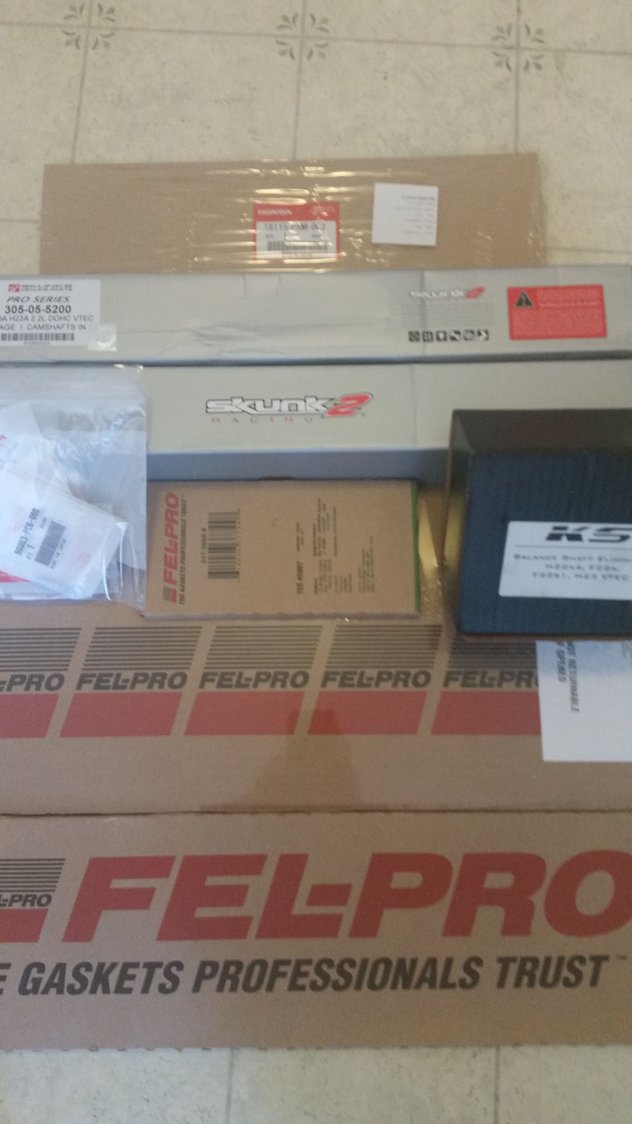

I just ordered type s pistons and vms cam gears. I just gotta figure out what valve springs/ret.
Well I still gotta order chipped ecu and schedule a tunnine session. Hopefully I'll have this together soon
