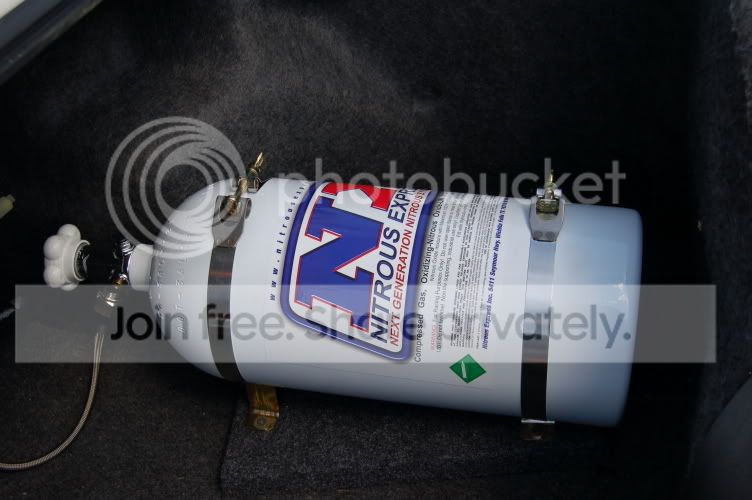

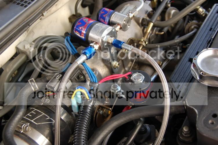

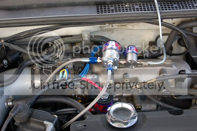

so i just did my first test run down the road with my new kit, i like it but i dont think its as fast as i thought it would be. does anyone else use it? can anyone give me some dyno specs? my dyno was really low. . . i'll put the pics up in a few. . .

Need more info, what kit are you running, what jets are in there, what is your bottle pressure. Something is definately wrong with your setup. Very low numbers. I made 42 whp and 65 ft lbs with a NX 35 shot, so you should be making lots more. Chances are your bottle pressure is way way low and your just running really rich.....but as i said, we need more info.

^^^as he said, you nitrous has to be between 900 and 1050 psi for it to be correctly jetted. Lower pressure means less nitrous and too much fuel (proportionatly). Your NX kit comes with 6 jets, so you have to use the 2 that coincide together to make it right. Look at the jets themselves and give us the numbers that are on them and we can tell you if you even have the right jets in. God help you if you have a 75 nitrous and a 50 fuel or something, you could be priming her to blow.
I highly recommend a few basic things to monitor your system, a nitrous guage and heater are really necessarry to make sure that your kit is working to its fullest. Without those things you will have a hard time getting it to perform its best.
