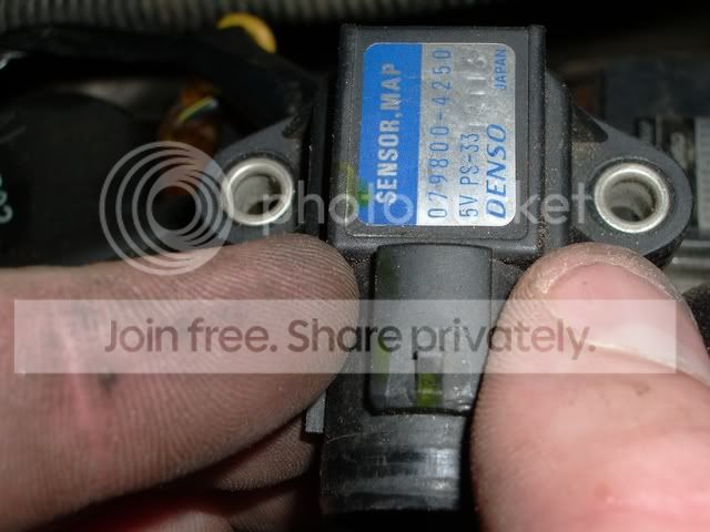

Here is a picture of what i found when i opened the box:

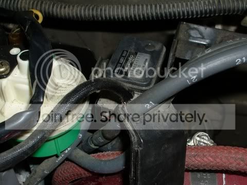

Here is a picture of the sensor that was recently purchased:
Am i looking in the right spot? Do i have the right sensor? I havent been able to find a map sensor that looks like the first picture or one with the same part number

that does look like the map sensor. H22 map sensors look different than other honda map sensors. they are the box design. check if it has a 3 wire harness going into it and if one vacuum hose is going into it. if this criteria holds true, then it is the map sensor.
