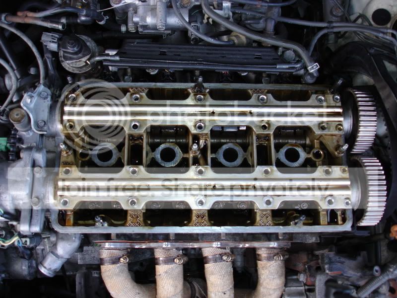

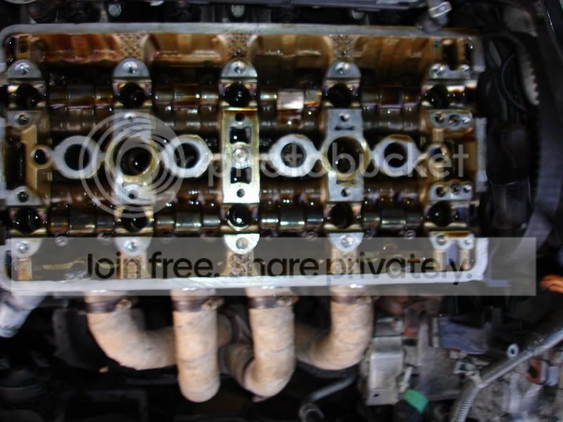

Old Jul 14, 2007 | 01:15 AM
ricedadee's Avatar
Posts: 58
I just started dig into my block today @ 4ish here is what it looks like but, in color
and then when you get the bolts off it looks like this
I'm going to finish it off may be in the weekend depending on how things go this post kicks *** hopefully things will turn out good when i get to the next block
chero mate
