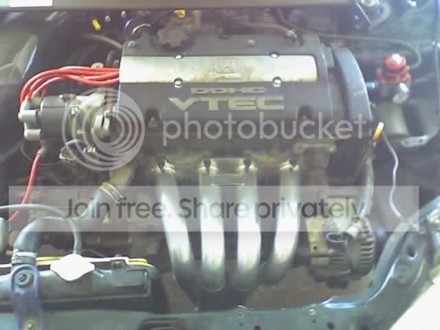

well the third pic down is my car. it fits great, KILLER top end and decent low and mid range. My header was a RAGE header but slightly different from the one mike sells. The header he sells is supposed to make more power overall then my design.
let him know its for a swaped civic when you order it. I believe they specific changes for that to help deal with clearance issues and not affect performance

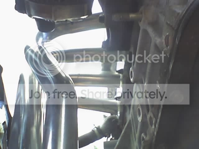

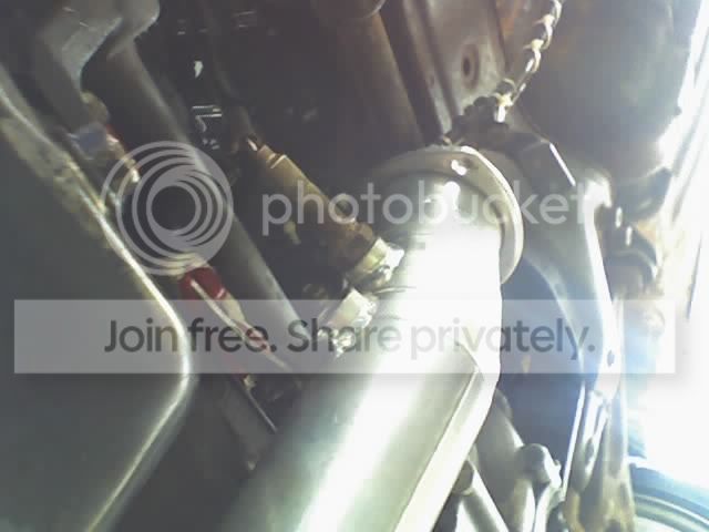

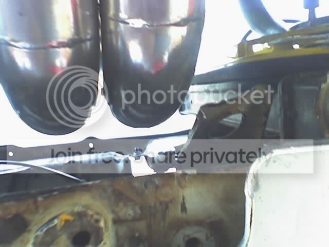

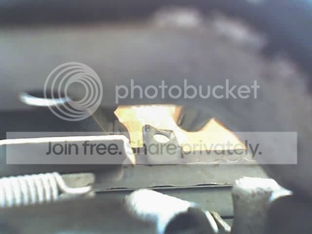

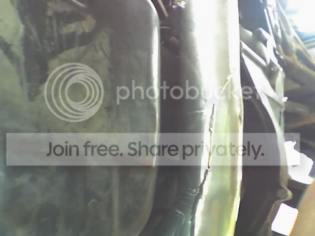

This is a different design but a one peice rmf header. This was done in a EG civic chassis. The header was made for 92-95 civic with an h22.
I needed to remove one of the a/c condensor mounts at the bottom for clearance issues. In the picture I left the mount on for reference. Noticed I bent it.
Top View
Bottom View:
I also needed to remove the alternator and alt bracket for more clearance. I also need to remove the stud where the a/c bracket used to be.
Pic of the oil pan clearance:
Collector and )2 sensor pic:
Wasn't too hard of an install, just some things needed to be removed for clearance.
