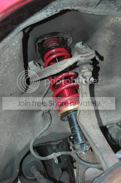

i did, and it was...that black plate is rubber...and those bump stops are like falling apart. And yeah it did come with instructions, but to the instructions, i put them on right. waht are yalls views on switching the springs...the back in the front and front in back, since the spring rates are different.
Old Jan 8, 2008 | 03:55 PM
  #31
117's Avatar
117
Posts: 2,336
From: DFW Area, TX
Do you people not understand that the picture was taken at full droop with the car in the air? With stiffer springs and stock OTS shocks, the springs WILL lose contact with the upper perch. That's normal. I wonder how many of you that are giving this guy "advice" have actually installed a set of GCs or similar coilovers...
For a street car, the stiffer springs should have gone up front. Do you know the rates?
It really looks like the springs are just too long for as low as you want to drop it.
Didn't the instructions say to cut the dust boot and use it to hold the spring isolator in place? It doesn't look like you've done that.

<TABLE WIDTH="90%" CELLSPACING=0 CELLPADDING=0 ALIGN=CENTER><TR><TD>Quote, originally posted by 117 &raquo;</TD></TR><TR><TD CLASS="quote">Do you people not understand that the picture was taken at full droop with the car in the air? With stiffer springs and stock OTS shocks, the springs WILL lose contact with the upper perch. That's normal. I wonder how many of you that are giving this guy "advice" have actually installed a set of GCs or similar coilovers...</TD></TR></TABLE>
Amen to that! There is so much bad information in this thread that it should just be deleted. That or some of these posts should be removed. I would hate to run into this thread with questions only to find a different answer on every second post
The car is not on the ground so the shock is going to unload itself which in turn is going to lower the entire assembly which causes the spring to lower itself from the top hat and isolator. Like 117 said, this is normal. I have koni yellow's with GC's and every time I raise the car on jackstands the springs uncompressed and sagged like in the pictures here.
The only piece of advice I can give is watch out when putting the car back on the ground. Make sure the rubber isolators are seated properly and make sure the springs seat into the isolators properly. Here is mine on jackstands with the spring dropped from the top hat. Make sure the isolator is up in the hat and when lowering the car, make sure the spring seats in the isolator nicely.

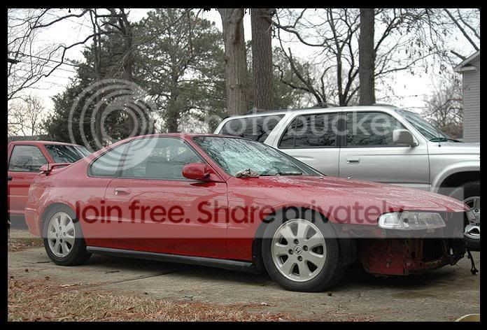

NP To answer your first question. I also noticed that I couldn't really lower the car that much. I was hoping for a little more of a drop but I also didn't play with the setup that much. I was told that with the koni/GC setup that you can't drop the car that much as it is for whatever reason.
Here is a pic of how she sits with the stock wheels and new tires. I checked the shock travel when the car was on the ground and it looked as if I only had about an inch of travel in the front. The rear was okay and could be lowered more but the front is what I was worried about. I also just sent an email to Ground Control about the circlips and where they should be if we want to lower our cars and still keep a good amount of shock travel. I do think it's car specific though.

im really pondering on switching my springs up...becasue my back springs are overly tucked, but my front isnt at all, im hoping my back will still tuck some if i switch the sorings and the front will drop where i want it...when ever i get some spare time is when i plan on it.

front, and the picture of my car, i dont have the back near as low as it can go.
