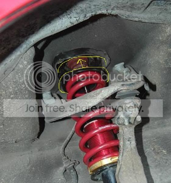

here's what i got

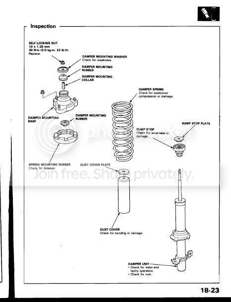

can you get a better picture? it looks like they werent reassembled correctly. i drew an arrow of how i think it should sit, which is why you arent getting much of a drop.
double check this:

thats jsut the bump stop, its sitting up there because i have the car jacked up and the shock isnt like compressed that allcomes together when the car is let down, and thanks for the help, and the diagram i jsut wish i could figure this out

You will not go low with those stock shocks. Judging from the picture you provided, you would have better results with lowering springs rather than a coilover setup. Buy some aftermarket shocks and put the coilover sleeves right over them and they should slide down much further than your stock system will allow them to. It's all in the geometry and configuration of springs and shocks. You can not go low if you only upgrade one of these components.
The C-Clip that they are refuring to are a part of Koni shocks and is not present in OEM shocks.

shouldnt that bump spot be around the piston inside the spring... not above the spring?!?!
i think that is assembled wrong

There's the problem, the bump stop is in the wrong place.

It looks fine to me. That gap between the spring and upper perch occurs when using stiffer springs in a GC or any other coilover kit. It's because the shocks have too much droop travel for the springs.
You should be using a cut OEM dust boot to hold the GC spring isolator in place, though. If you don't, you could have problems with the isolator down the road.
Also, if you want to go that low, you need to cut your stock bump stops.
To me, it looks like your problem is the free length of the springs is too long for the spring rate you've chosen. Either get softer springs, or springs with a shorter free length.
What are the exact specs of your setup? Shocks? Spring free length? Spring rate?

dude, the bump stop is installed incorrectly. it's supposed to be on the piston/shaft of the damper/shock assembly.

well i dont think its the bump stop because thats a really thin piece of rubber and it jsut goes right through that, nothign stopping it from going farther like into the springs...is that what you mean?i think i jsut need better shocks.i dont know if these are stock shocks for sure though for some reason i remember them saying like monroe on them or something.

im gonna moove the bump stop to where it should be and see it that helps
