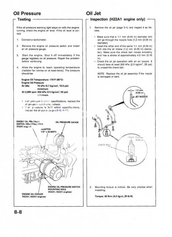

it is ment to inform you you have severly low oil pressure however the oil pressure switch can fail. Your going to have to check all the things named above
and probably check your oil pressure with a mechanical gauge.
Old Sep 29, 2007 | 11:15 AM
mikemjohnson's Avatar
Posts: 49
From: Charlotte, NC, USA
good diagrams and directions, thanks champ
