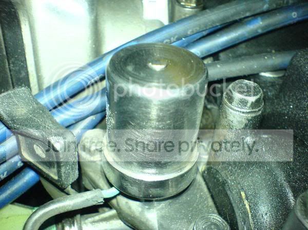

Old Jul 13, 2007 | 07:06 AM
jdmh22a1's Avatar
Posts: 380
From: Bakersfield, Ca, US
Right behind the dizzy....distributor....it looks like this...
this is 1 off a b16...but this is the only close up of the vtec solenoid....

thanks, took it out, cleaned it but there was no screen. I clean it out anyway. ill let u know if it worked.

Maybe he just took off the top spool valve portion, and not the actual VTEC solenoid as a whole unit. I made that mistake when I was a noob at working on cars. The screen is behind the VTEC oil pressure switch, inside the gasket.
