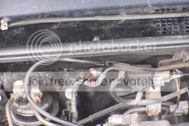

picture of vacum line thats creating all the havoc!!
Old Jul 29, 2006 | 09:52 AM
ShinobiLude's Avatar
Posts: 336
From: Blacksburg, Virginia/ Dover,DE, USA
Default Re: code 5; MAP sensor?? (egcoupe94)
Cory,
The map sensor on the firewall has got to have a vacuum or it cant get a proper reading. Without the vacuum its just the same as it not being connected at all. The map sensor vacuum on the f22 intake manifold is on the throttle body I believe. If you have a throttle body that has the map sensor on top of it of course that connection wouldnt be there. Take one of the blocker plugs off your extra vacuum connections on the intake mani itself and hook up the map sensor on the firewall to that. It should eliminate this issue.
For the love of God get that other bolt. You have been talkin so much shyt to me cause you got your swap done first. HA!!!!!

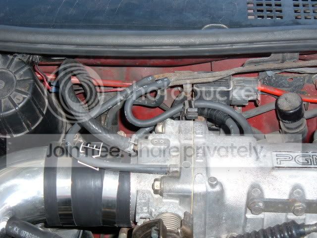

i took a pic and hosted it for you.
hope this helps if you need anymore help let me know.
yes i am a white man
yes you need to send me $20 to my paypal.
Old Jul 30, 2006 | 01:17 PM
92hondalude's Avatar
Posts: 2,370
From: Kitty Hawk, NC, 27949
Default Re: code 5; MAP sensor?? (92hondalude)
the first video you had the vacumes all fucked up
i dont think you have the right TB
it looks like you got the 5th gen tb witch has the map sensor on the top of the tb.
try unpluging your old one and plug it on the one on top of your tb.
Old Jul 30, 2006 | 03:20 PM
.BigSexy's Avatar
most hood white kid
Posts: 9,505
From: Nashville
<TABLE WIDTH="90%" CELLSPACING=0 CELLPADDING=0 ALIGN=CENTER><TR><TD>Quote, originally posted by 92hondalude &raquo;</TD></TR><TR><TD CLASS="quote">the first video you had the vacumes all fucked up
try unpluging your old one and plug it on the one on top of your tb.</TD></TR></TABLE>
i have to lengthen the wires. I found out today I had a vacum leak which wouldnt let it idle right. swapped ecu's for a JDM p13, and idles good now, still gotta fix that MAP. going to do that tonight
Old Jul 30, 2006 | 05:08 PM
gooseman's Avatar
Posts: 27
From: midwest
unplug it from the firewall and plug it into the MAP on the TB
