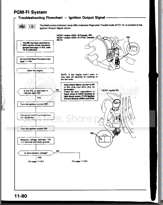

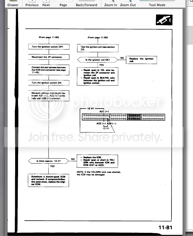

Ill put up the next page when it uploads
Edit: pic added
