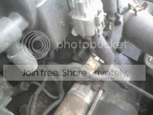

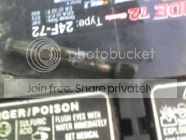

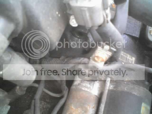

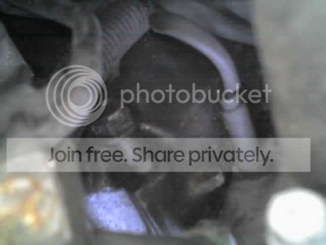

93 h23... I was checking under my hood because i saw some blue smoke coming from the engine bay and found this bolt half way in the block. check pics below. could this be causing my smoking problem (doubt it but worth asking), what future problems am i looking at from this, and what would be the safest one to get it back in place?? took pix with cell phone sorry if they suck.
wide shot
Close up
Placement
Bolt
Looks like its suppose to hold teh starter in place but i'm new to all this so any input would help.

it won't cause any problems, but that's a bolt that connects your tranny to your motor. I'd just put it back in

HOLY ****! that's a bell housing bolt.( keeps the engine attached to the transmission) But it back in, you should be able to start it by hand unless whoever forgot to install it fucked up the threads.
