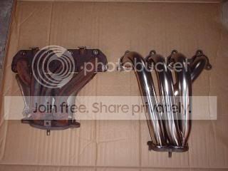

came with the motor and has the JASMA "Carb" approval on it.
Will a exhaust shop be able to work with it since I don't have the 2-1 connecting piece?

Def. not a DC, megan, or ebay crap. Don't japs brand their products!? It would help a helluvalot in finding the missing 2-1 part or I'm guessing here that a shop will be able to put something together?
I've seen plenty of others getting these non-branded headers with their jdm motors, with the same JASMA cert..
<TABLE WIDTH="90%" CELLSPACING=0 CELLPADDING=0 ALIGN=CENTER><TR><TD>Quote, originally posted by 98vtec &raquo;</TD></TR><TR><TD CLASS="quote">i got this header as well when i first received my JDM swap from hmotors. it looked like a pretty nice piece that i would have put on par with mugen or fujitsubo. Too bad it didnt come with the lower piece.</TD></TR></TABLE>
yea, that's y I'm investigating it so I can buy the missing piece. What did you do with your header?

You might be able to get something custom fabbed, but I don't know that a local exhaust shop would be able to handle it well. To do it right, you'd probably want a 2-1 merge collector (like from Burns Stainless), pipe with mandrel bends and then you'd have to get someone to punch a custom flange to bolt up to the primaries. The cheaper option would be to check what your clearances/heights are and see if the lower section from something like a DC or Megan will fit, assuming the flanges match up.

That sounds just about right. Do you think it'll be worth all that work to stick with this header? I found what looks to be a part number..
FGK 11846
Seems like it is a Fujitsubo as pictured above. I was not able to find any parts with that number..so I am going to assume that it is the Fujitsubo Super-EX Header.

The piping and welds look pretty nice, so spending $200 or so to finish it out could be worth your while if you're looking for a good header. You could try contacting an american distributor of Fuji and see if they can order just a bottom section...
