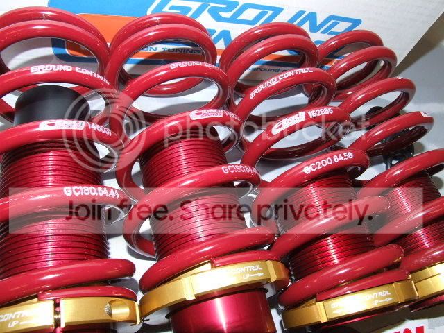

I grabbed all this stuff at once, trying to cut down on shipping...the coilovers look nice

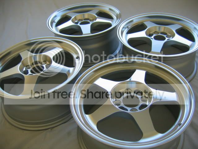

I also bought some Nippon Racing F-2 Rims, 15 lbs 1 piece forged aluminum.
Heres the coilovers-

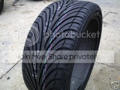

My favorite tires of all time, back when i had my 240 these tires grip awesome! NEXEN N3000!!!!! FTW

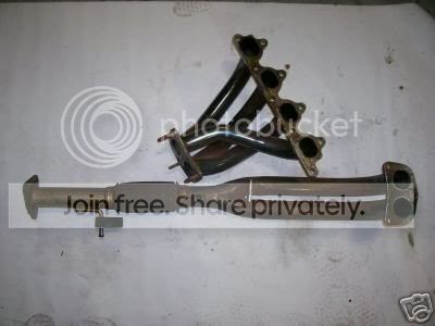

My 40 dollar h23 header..

So you are calling Ground Controls shitty? Nice.
Next you are going to tell me that teins are the bestest!?!?

btw, I would sell those springs, and get something different.
It looks like you have a ~7", 250lb spring and a 8" 330lb spring.
I assume they want you to put the 330 up front and the 250 in back, but that won't handle too good. You want something more like a 2 sets of 7" springs in the 350-500lb neighborhood. Preferably putting the stiffer spring in the rear.
I'm running 400f/450r right now, but wish I had more in the rear.

Posting the picture afterwards has nothing to do with what you said. GC's are the same design that you call shitty. They are a sleeve that fits over a shock body.
&lt;-- tired of people talking about "real" and "fake" coilovers.

good deal...but I don't think nippons are forged.
Old Nov 21, 2006 | 09:12 AM
BlownH23a
Guest
Posts: n/a
Default Re: 92 Lude Coilover kit help. (soundbomber)
says it on the box...LIGHT WEIGHT FORGED ALUMINUM WHEEL

What size are they? A forged 15 like a Volk for example is under 9 lbs.

they are 16x7, they weigh 14.7 lbs. Volks are nice but they cost too damn much.
