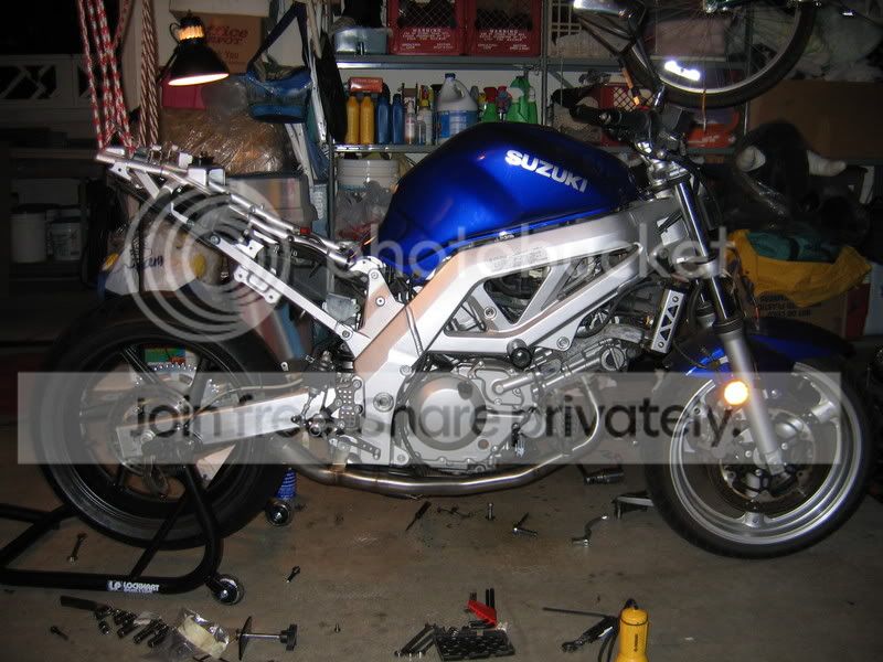

so here's my new problem. the rear wheel isnt fitting. i looked on the wheel and it says "J 17XMT5.50 DOT". so does this mean that the wheel is actually 5.5in wide instead of 5 in wide. cause that might be why its not fitting. i did get it from a guy who brought it from japan and maybe they have different spec wheels over there?
i did get a spacer kit off ebay that is supposed to be specifically for putting the honda f3 wheel on an sv650 but so far the wheel isnt fitting without the spacers and impossible with them, unless im doing something horribly wrong.
here is the bike with the rear wheel on but no spacers and no caliper mount because i couldnt fit it on:
here you can see the left side of the wheel where the larger spacer is supposed to go and its flush against the swing arm:
here you can see the block that supports the caliper mount and how close it is to the brake disc, no room for the caliper mount:
and here you can somewhat see how far off the caliper mount is off from fitting:
keep in mind that the bracket is flush against the brake disc in this pic and the hub of the wheel where it must mount is a little further out so that gives it even less room, and there are no spacers in the wheel that are supposed to make the wheel fit. so does anyone know what ive done wrong or if i have the wrong wheel that is too wide? im going to join and post this in socalsvriders.org aswell but just thought id see if anyone here knew anything. thanks again for everyone's help and just for viewing the build.

If it's a 5.50 wheel, then you have a 900rr wheel. The f3 wheels are 5.00, f2's are 4.50. I think you will need a new rear wheel.

"J 17XMT5.50 DOT
that reads
17 inch wheel 5.5 inches wide.....
