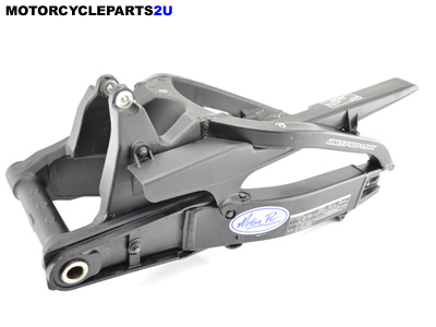

600RR swingarm:
VFR800 swingarm:
Notice anything different? Okay, obviously there's differences, but look at the shock mounts.
Here's a naked VFR:
Naked 600RR:
The problem? Top of the CBR shock mounts to the swingarm. Bottom of the VFR shock mounts to the swing arm.
It's not a direct fit and you'll have to do some modifications to your bike to get the shock to work.
