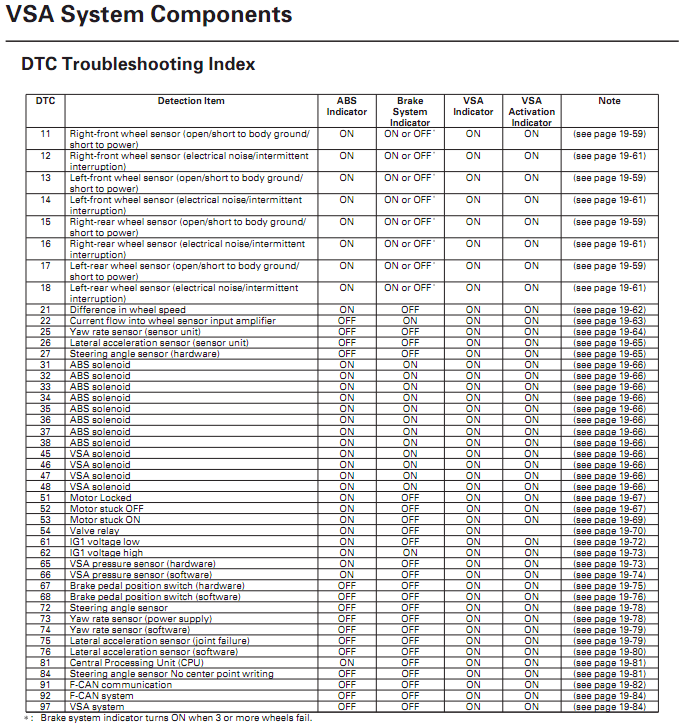

I suspect a wheel sensor might be a simple initial check. But the list of things that can illuminate the VSA light is long.
