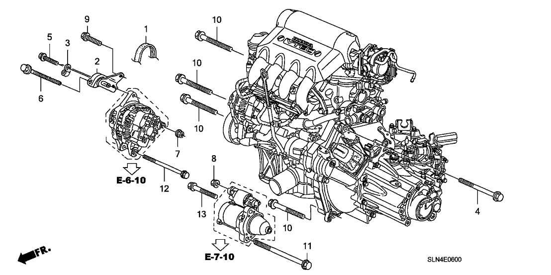

OK, I finally removed the starter bolt on the top but the starter isn't budging. The bottom has what look like a pin. There's no bolt on it. What am I missing? This is a much bigger job than I anticipated.

The two mounting bolts are removed from opposite ends. (#11 and #13)

OK. Thought that it was just a stud. THANKS.

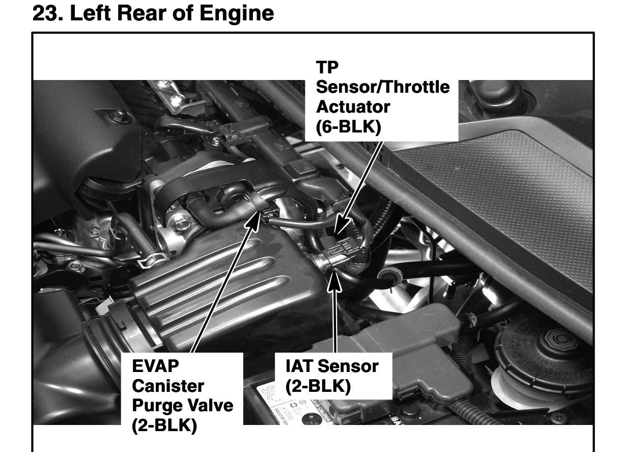

I just re-checked for your model year. 2007-08 Fit only had an IAT sensor. So, no MAF (Mass Air Flow) sensor on your model year. The model years after had a combo MAF/IAT sensor.

So do you recommend just replacing the IAT? It was working fine before I took it apart to change the starter... should I get the codes while it's running or with the ignition on? I'm thinking that the plug isn't making good connection but I wiggled it and no change.

No, don't replace the IAT. There wasn't anything yet to indicate it may be the IAT.

I'm getting two errors.
#1. "Intake air temp sensor, high
#2. Evap system leak test failed.
I'm not too concerned about the Evap error but the IAT sensor may have been damaged when I removed the plug. It was working fine until I replaced the starter.

I replaced the IAT sensor and left it out of the airbox and it idled at 2000 rpm but steady. So I plugged it into the airbox and it did the exact same thing, rhythmically idling down and up. I'm out of ideas.
