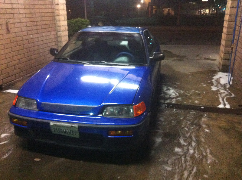

shes a 90 CR-X Dx
clean title but was in a previous front end accident
and i took her to the wash
