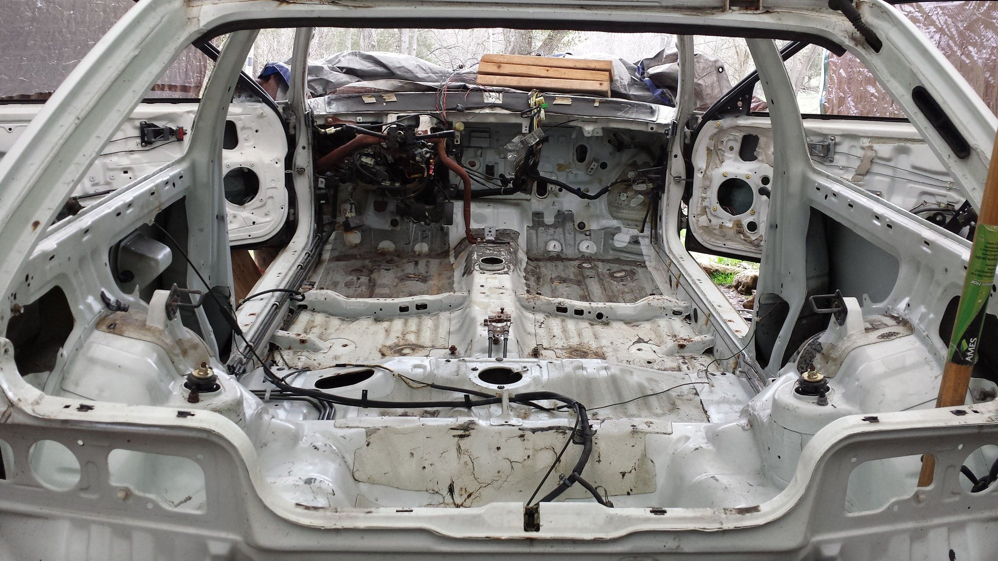

Inside all cleaned up/painted

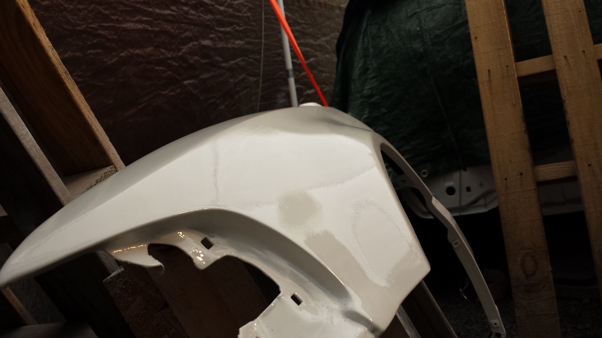

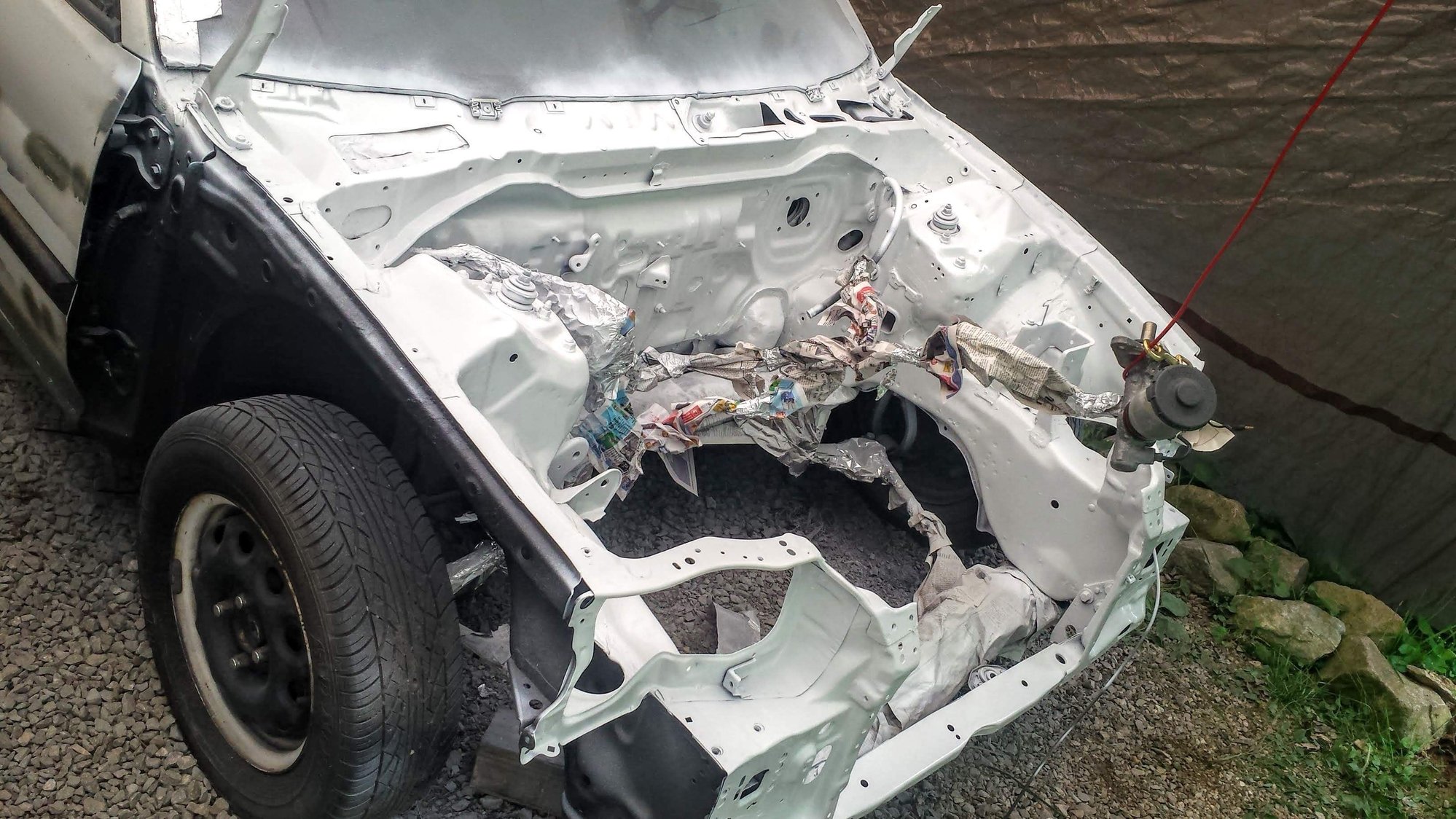

Never should have started doing this....
Paint day
Roof got chalkboarded

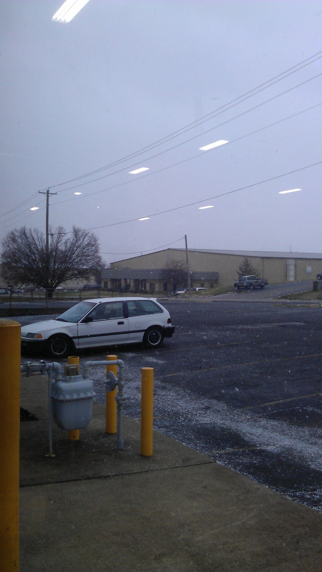

Way she goes (to my work so I can finish it this winter)

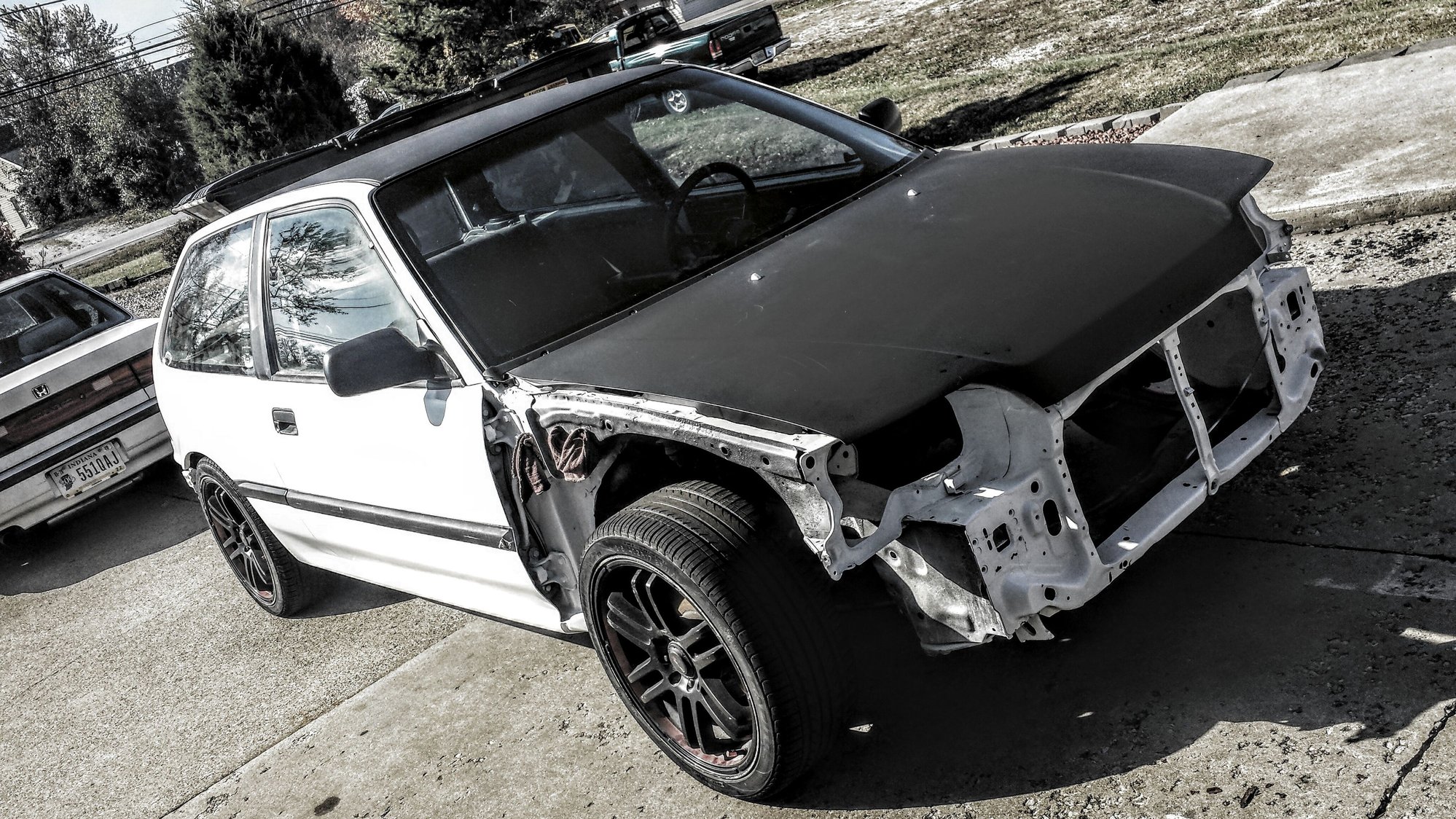

Bought a wrecked si and used the interiors vs my blue dxness
New windshield
Current status

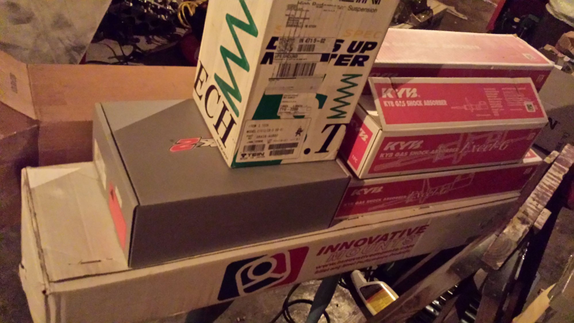

suspension going on whenever I get a free weekend..?!?!?...
​​​​​​innovative trac bar, sk2 upper cas, kyb strut,tein springs 6 sway bar kit, (El cheapo), lcas, and have the 2 factory si bars from the wrecked si I got

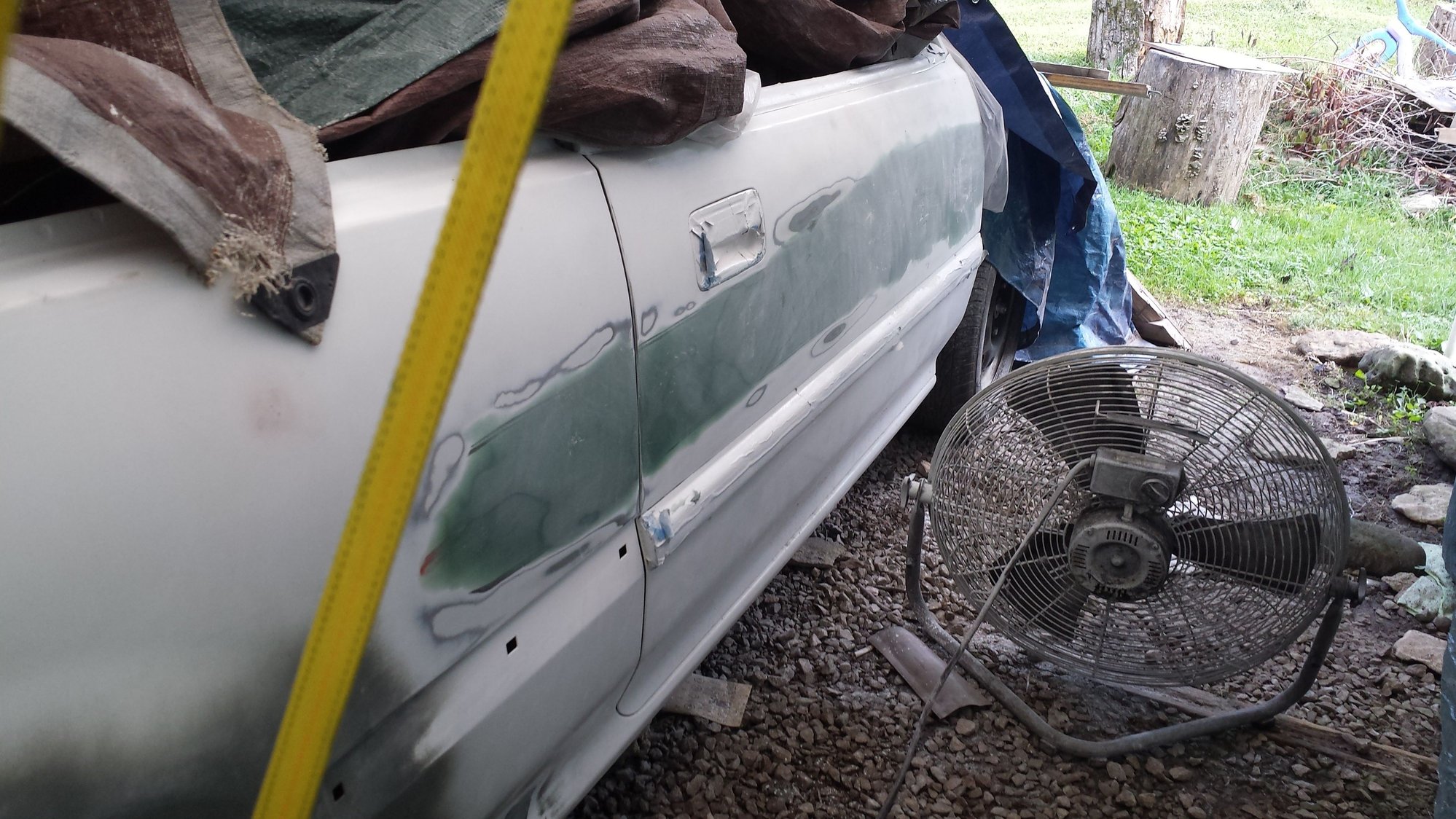

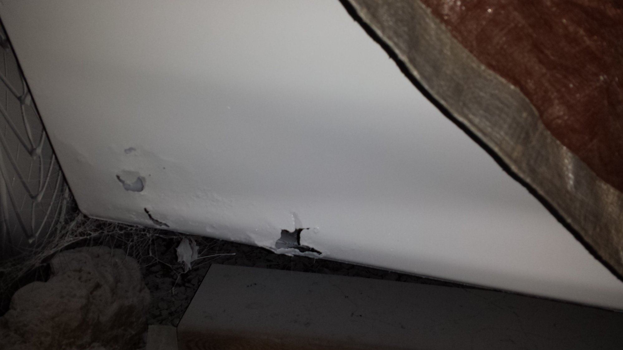

The first time I painted it the summer before last I just could not handle the rust holes being there. Lol. So I made the terrible mistake (will never attempt body work again) entirely too much labor / lack of proper tools.
Swiped pre ownership

Remind this has all been done in the backyard, bugs, rattle cans, hand tools, but majic can be made on a budget. Rustoleum gloss white and spraymax 2k clear much better than I ever expected..

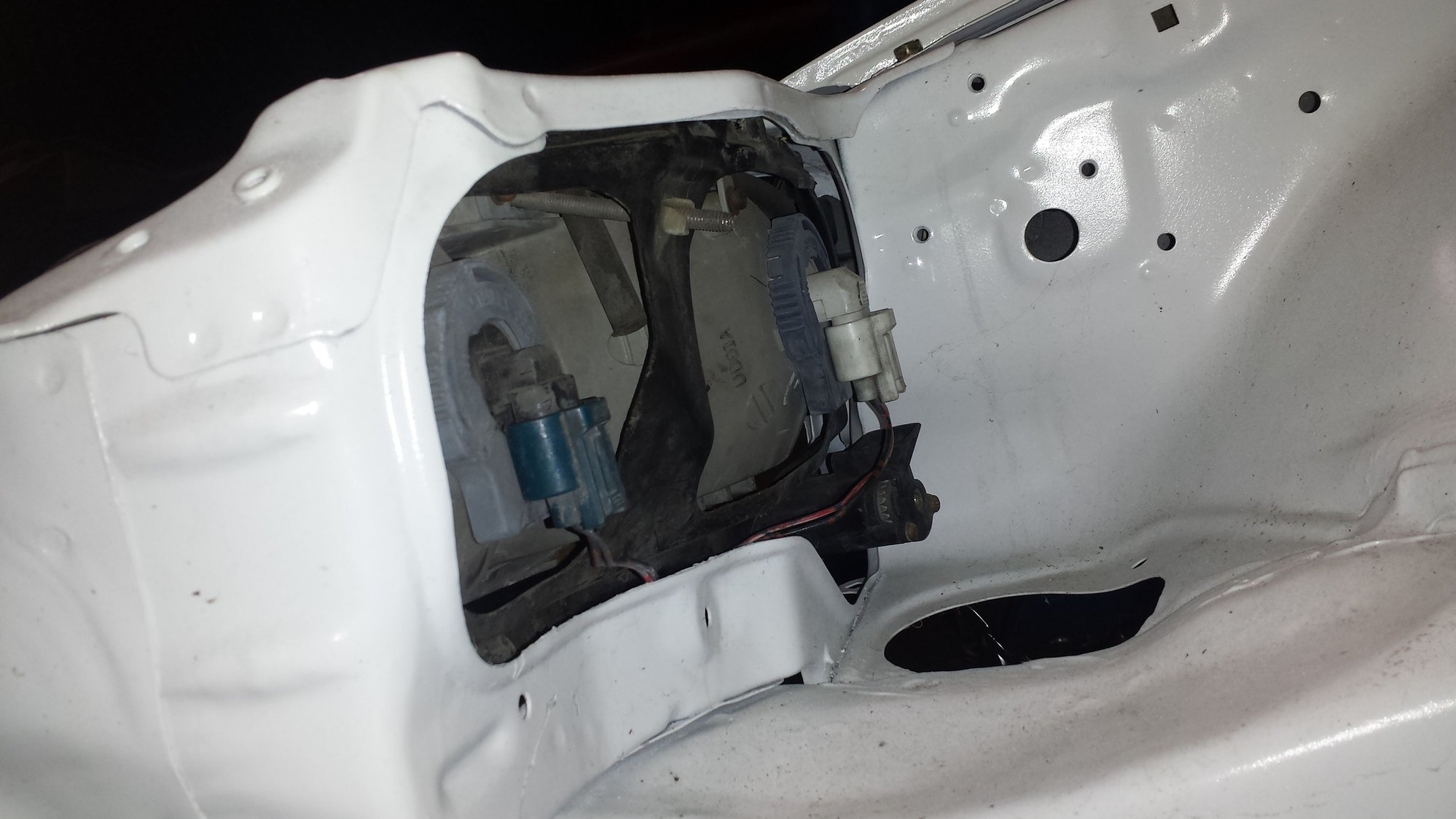

That center white body piece under the headlights is a absolute PITA by the way!! I left the top bolts out of the crash bar so don't have to disassemble the entire front end to remove the bumper anymore. Which is off because it's easier for me to pull it into the shop that way. It's uphill and I have to get out and pull it in.

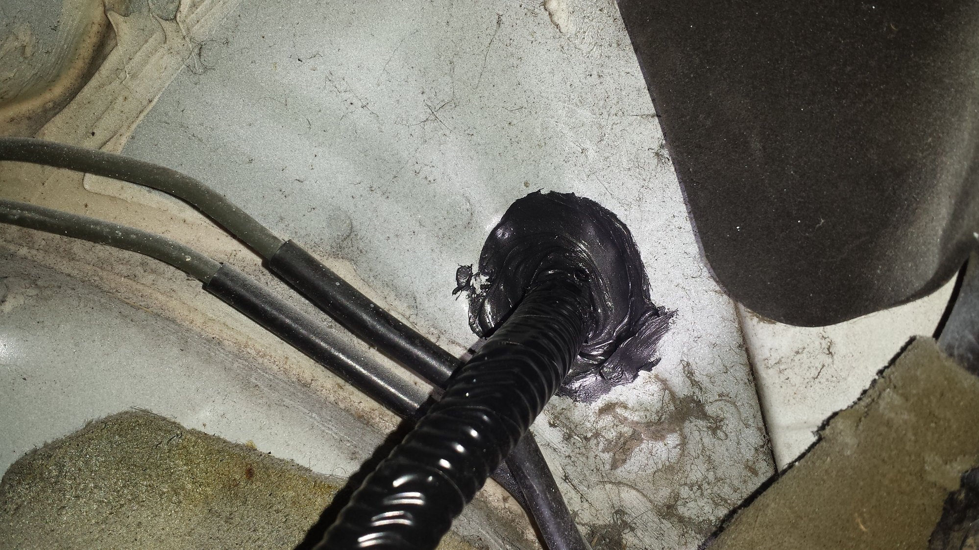

Notched out
Cutout back in
Cut out the center
Gobbler full of sealer
Inside
thar she be

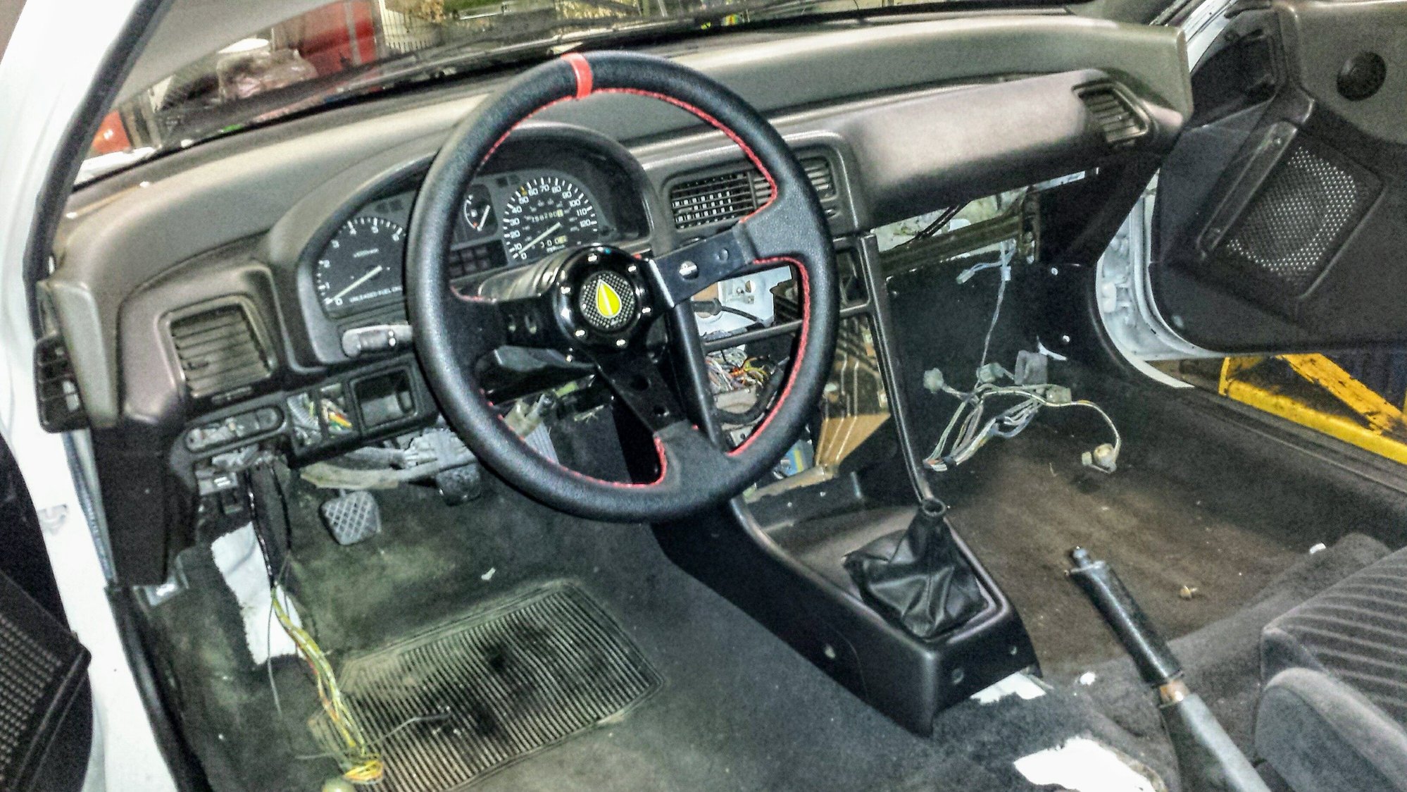

Got the crx dash in tonight
About time.
