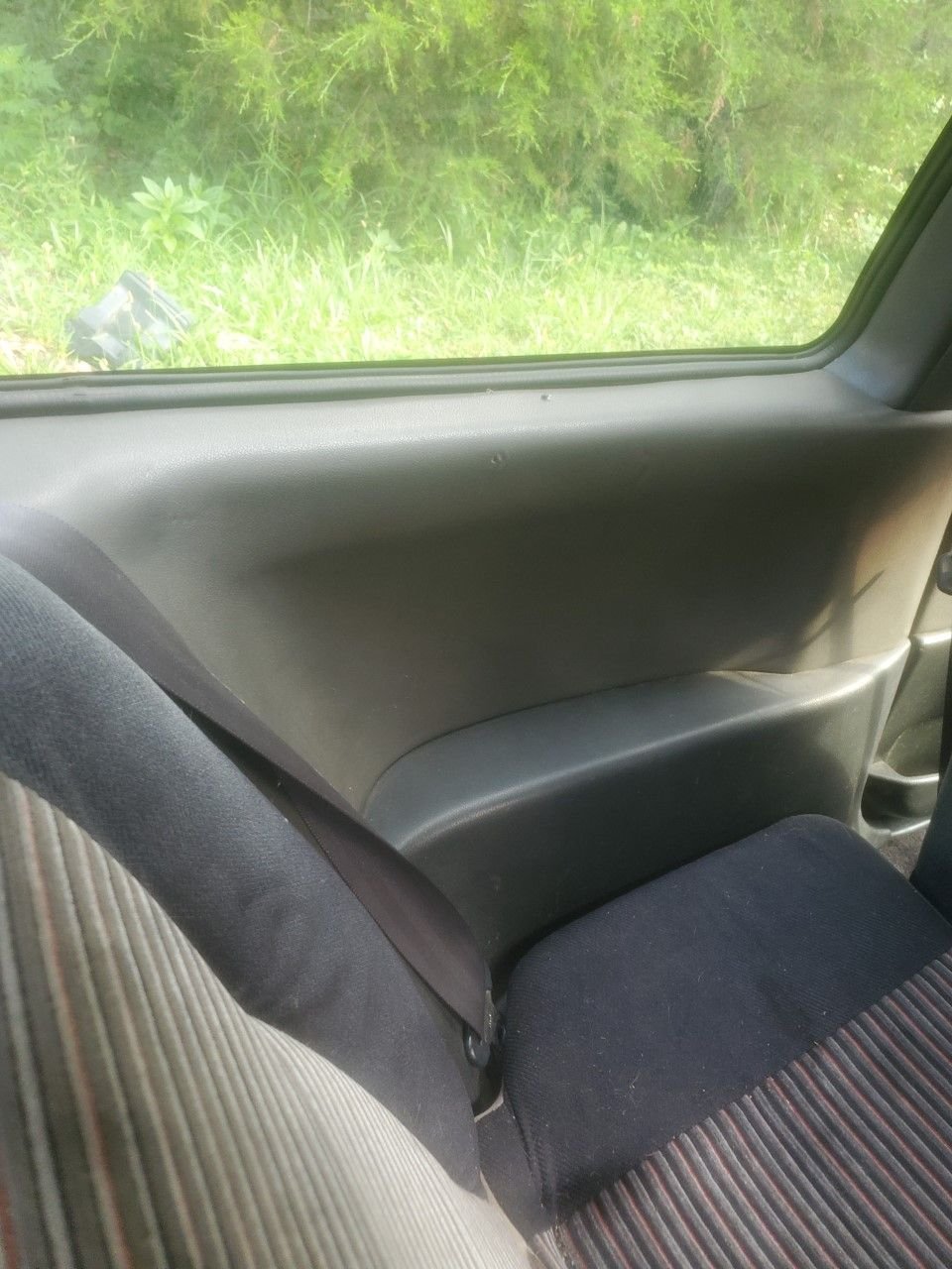

For the model years 1988-1991 is there anything, other than color, about the hatchback interior trim panels on either side of the rear seat that changed? I am looking at a set of them from a 1989 and wondering if they will work in my 1990. I know they changed the seat belts between those years and that affected the B pillar trim but I'm not sure what else in that area might be affected. I checked the part numbers and the part numbers did change between 1989 and 1990 but sometimes it seems like they change even when I don't think the part actually changed.

The physical aspect of them should be identical between the years.

When you're looking at USA part numbers, the 88's had pillar mounted seat belts. 89-91 had door mounted seat belts.
Everywhere else in the world had pillar mounted seat belts.
There is a slight gap between the B pillar plastics and the quarter panel plastics where the belt passes through.
The gap wouldn't be present on door mounted belt cars. I don't know this for fact, but that's what makes sense to me based on the facts I know.
