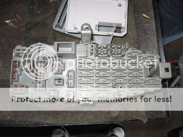

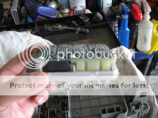

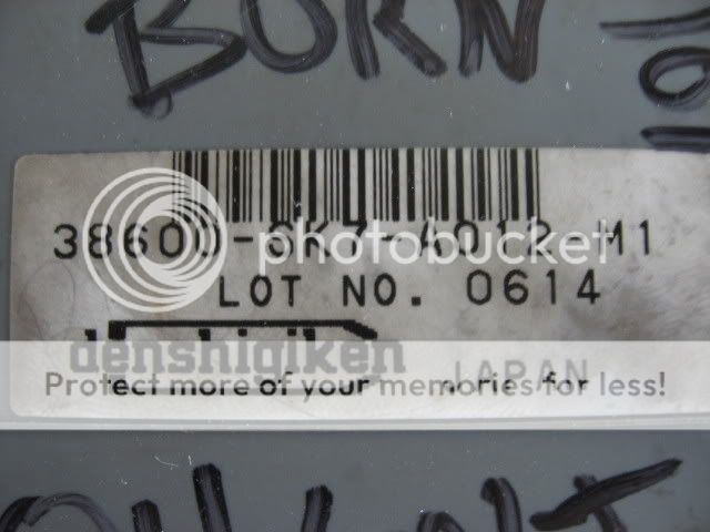

***OIL LIGHT is Flashing ON not Constantly ON**
All the stuff mentioned was taken in by consideration before the motor was assembled. My motor work knowledge and assembly knowledge speaks for itself from all the customers i have had in the past and presently. I used and searched for similar situations here on H-T and results are all the same. "change oil pump, change pressure sending unit/s, and all necessary things that will cause oil to flow, read, or even leak".
What happens to the situation when its all purchased brand spanking new from OEM, OEM Replacement Parts, or even Numerous Automotive Parts stores??
This is just a suggestion its not saying this is the main problem but something to look at. Not all would consider looking into specifics. But you can easily trace back solutions in the Haynes Manual. That manual is where i found out the answer of why the oil light keeps flashing.
Main Fuse Box under driver side Interior example being used is a DA
Part Number
Fuse Box Taken Out and Removed Parts to show location
Integrated Control Unit Located in the back Of Fuse Box
Exposed Integrated Control Unit Board
Top View and Part location of Failure
Burnt Heat Spot on Board Zoomed IN
Burnt Spot Pointed Out Far View
Please Refer to Page 12-28 Chpt 12 Chassis Electrical System On Haynes Manual for Acura Integra (1990-1993) and Chilton Manual for 84-91 Civic/Crx page 6-96 Chassis
Electrical. Its all have to do with wiring.
Thanks for viewing

Did you read the flashing light comes on for the short in the relay part that i show the oil light that comes on and stays on thats not the problem here if you want to start your own thread about the oil light that just stays on then do so...
My thread is to inform peeps with a flashing oil light flashing means there is a short in the wiring...
Now if the oil light just stays on then you would do the following check the oil level,check oil pressure,check or even change oil pump...
Now i just did a rebuild and all that was done fresh oil,fresh oil filter,fresh oil pump,fresh oil pressure sending unit and the problem is the oil light started to flash or blink and the problem was the intergarted control unit and nothing else...
