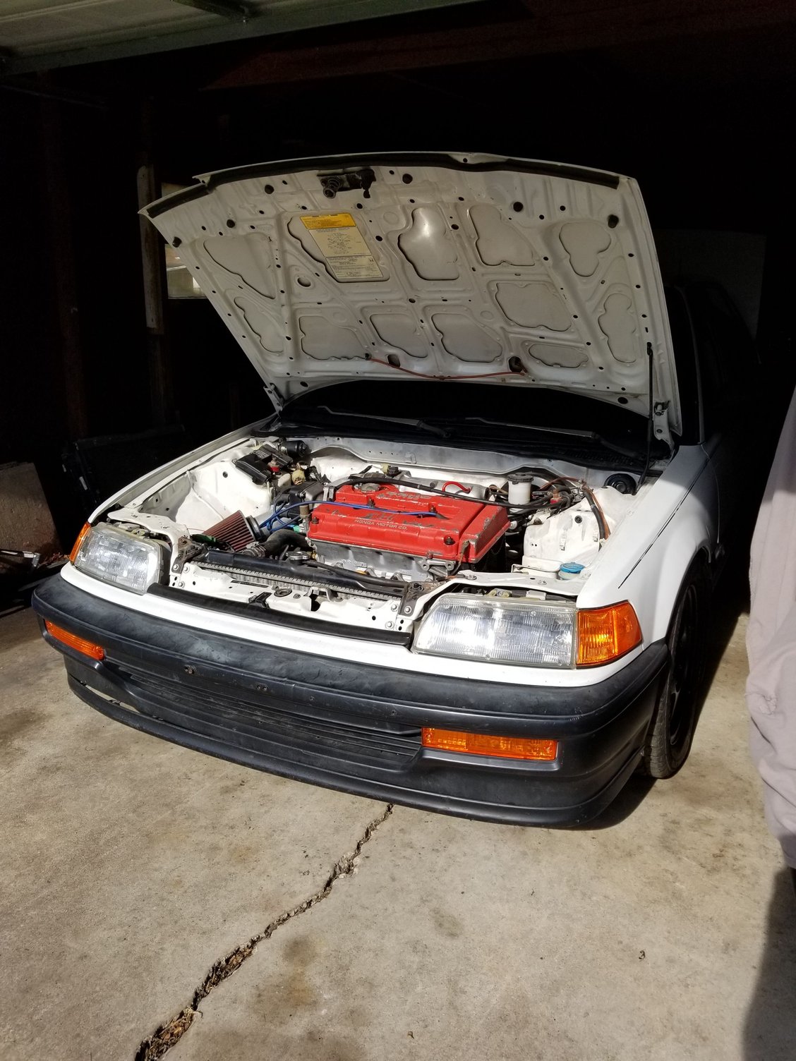

yep just a lowly 91 dx sedan i felt needed saving. Virtually rust free chassis up here in wisconsin is a rarity, so the money pit it becomes. Started by buying the car from a buddy who had it for several years. He added a b16 and ran it for a while, then began a teardown and converted to a b20v motor. Got it together enough to start, but "it ran like crap" so the project got shelved for 2 years. Thats where i came in and bought the car, not running. This is what i know about it
91 civic dx sedan
b20b bottom end
12.5:1 supertech pistons
Arp rod bolts and head studs
new bearings
b16a head
type r cams
B16 cable trans
First thing i did to the car was ditch the stock wiring harness. Full of sketchy splices and butt connectors, i purchased a rywire obd1 budget tuck harness. Battery had been relocated to the trunk at some point, and was completely dead. Picked up a braille b129 battery for it. A powersports battery that weighs 9.5 pounds. No ac, no p/s, it can handle the task.
I reached out to Rcautoworks in bridgeview. il to help me with tuning. I brought him my ecu and he gave me a chip to get my car running. Will be visiting him for some valvetrain work before final tune, pending a perfect bill of health once its running. Great dude.
Slowly but surely, im making progress. Ditched the stock fan for a slim ebay, began the wire tuck on the engine bay(still in process), and started tidying things up as i go. I am almost ready to start the engine, want to change the oil, add fresh gas and prime it before firing. Wish me luck. Will be adding updates as i go, not sure if anyone uses forums anymore for build threads....

Wow I forgot about this. So update!
I bought an OBD1 b18c from hmotors.
I had manual gearbox LLC build me an OEM GSR trans with mfactory lsd.
rywire OBD1 budget tuck harness
JDM p72 (Yes I wired in the IAB)
she's in and everything ready to go back together I'm literally just stopped on super small stuff. I bought fortune 500 coilovers and mpc drop forks I haven't installed yet.
Exhaust needs to be welded to work haven't fired up the motor yet. Changed timing belt and all the good stuff in thereHave 205/50/15 gram lights going on too. I can't wait but also I have been dragging. Sold the b20, moved out of that house into another. Car will be done soon......

That's one nice set up... i got a b20b low compression also a b20z with b20 hydro Tran conversion ..obd0 pr4 chip t3/4 turbo 7 psi ... I get more pictures once I going back in... what axles you using 94 Acura integra?
Re: My 91 Civic dx sedan b series build
honestly I'm running the exact same axles that came with the car that ran the b20. I do not know exactly what they are, but I'm guessing definitely not 94 Acura, most likely 90-93 Integra axles
