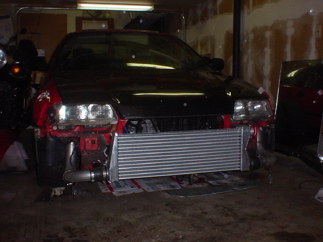

Friday Night we had the dP's all welded up, and I was doing test fits with the intercooler. I forgot my camara this day and was in such a hurry to get this thing done. I had alot of friends give me a hand to finish her up.
Charge pipes were a hoe, the duel inlet on the intercooler was a very bad idea, and wish it was setup like a normal intercooler.

Another shot.. yes its very cluttered right now, plus I had a little incident with coolant blowing everywhere, onyx left the coolant drain plug loose and I didnt check it :-\
I dont care whatcha guys say.. I like flat black... btw, can you see the welds on the intake mani? Lionel ground them down flush and you cant even see them. Looks great! Only 1 flaw in this manifold design and the end cap wasnt rounded (bulged out) instead it was just capped off.

Completed.... Saturday Morning, I wanted to get this thing done for a local honda-tech meet, and for some local street racers saying that I was talking bullshit about a TT setup. You should of seen the peoples faces at the honda-tech meet. One guy asked "Who brand manifold is that" I told him it was a Drag Gen 7 beta 2b. rofl
Yes, it fits, Yes it runs.. The questions Is it fast? I'd say so. Honestly, I've never had a turbo setup sound like this. It sounds really werid, almost like my Buddies Rotary. I've drove lots of turbo hondas open DP, but nothing like this. Boost comes in incredibly fast, way faster than I thought. Spools 5psi around 2800rpms, and holds 7psi all the way to 8300. When the ITR cams kick in, the thing gets pretty wild. I'm running my old ls/vtec turbo spark & fuel map. Seems to be running pretty good but needs lots of minor adjustments. Coolant leaks probably that (coughusedheadgasketcough) and the oil leaks from the return pretty bad. Thats what you get when you flatrate ****.
Overall it was a fun setup, would I do it again? No.. lots of people kept saying "what a waste of money" well, this entire setup didnt cost me much at all, I get lots of little perks from HMT so it lets me do this kinds of stuff on a cheap level. This was just an experiment, just to have fun and see how well it performed, I'm not here saying twin turbo setups are the ****, in fact.. they are a pain in the ***, and I cant wait to get my single setup on.
What am I expecting of this? Well I'm sure I'll dyno it, and see if I can get 300whp out of it, maybe rape it around a bit more, save some money and finish up my built ls/vtec and put on my 62-1. As far as how fast is it? it's not nearly as fast as my Crvtec Turbo, but it does have that nice b-series pull

Like someone else mentioned, wouldn't you want Cylinder 1 and 2 and 3 and 4 together?
Just wondering?
Like when you look at a 4-2-1 header, they merge 1 and 2, 3 and 4 together because of the exhaust pulses....
Just curious.
Either way!
Just wondering?
They merge 1&4, 2&3
I want to see this car in person so when are you going to build a twin engine turbo CRX? I think thats the only thing you haven't done so far
They merge 1&4, 2&3
It was mainly for design, I wanted the manifold to be simple, and look simple. Glad you guys like it. Just drove it to work this morning, and ya.. the used head gasket failed me, I always hated re-using head gaskets, but I was lucky on the last one I used. I'm so tired of working on this thing, I think I'm just gonna put it in my garage all week and relax.
