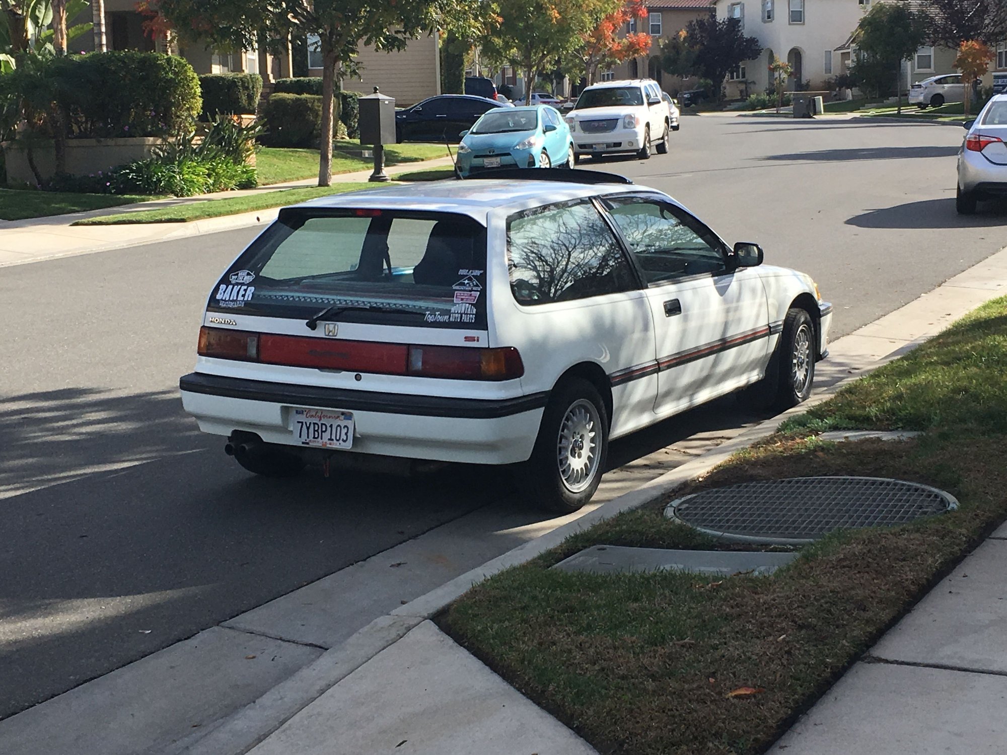

wonder how you were able to get one of these in this day and age?!

It’s a funny story but I got it off the original owner
hew was an old Air Force pilot ,
it was his grocery getter
