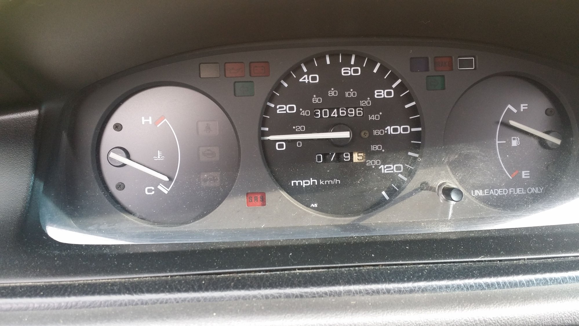

My problem is the car while driving does not warm up to operating temperature but if idling it will reach it after awhile..
Now i know thermostat right!?!
Well this is my third OEM thermostat from the dealership. 1st a 95 cx thermo (d15b8) 2nd a 90 crx si thermo (d16a6) and 3rd 95 cx (d15b8) as of yesterday.
No way i got 3 faulty thermostats in a row. So has any1 experience this? Any advice? Whats my next step on troubleshooting this?
Thanks!
I let it warm up for 10-15min then drove 15-20min to work parked snapped a pic..

Id like to add that something is over cooling it.
My needle operates as it should.

Thanks for all the help and acmoc hit the nail in the head.
I tested the ECT and it is faulty and hopefully the problem with my overcooling.
Will be ordering a new thermistor soon.
Now my test wasnt 100% accurate but accurate enough i believe. [I was going off my dash guage]
It was reading k-ohms about 0.33 and the temp gauge was just above C on the dash. It even went as high as 0.2!
Cold it was reading between 0.5 - 1.
