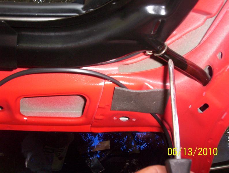

tired of water leaking into your interior? and hatch area? i was so, i gutted the inside. sat inside of the car during a rain storm.drove it up and down the road to get the water draining thru the suroof drains. and this is what i found
Old Jun 13, 2010 | 04:16 PM
bad 91 teg's Avatar
Posts: 332
From: palm beach, florida
Default Re: civic si leaking water inside.HERE ARE SOME PROBLEM AREAS
the first one there is on the doors ..water drips in that top hole runs down FRONT of the door resulting in wet speakers. i used some metal tape and stuck it on from the inside. if the water drips on the inside it is ok,because the speaker pod is louvered were water will not run in. even with the plastic in tack it will still leak onto your speaker and ruin it after time. this will devert the water.

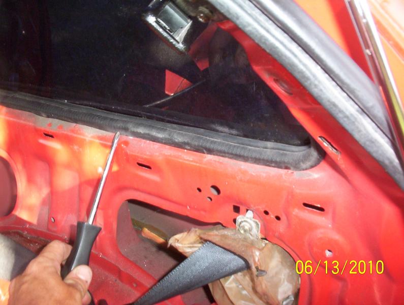

here are the sunroof drains . there are 2 . the front and rear. check them for leaking ,or cloged up drains . as you can see my rears are a little rusted.

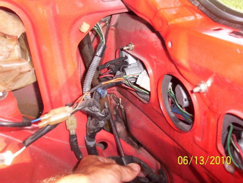

here is where the drains drain out. mine was disconnected .resulting in water pouring in. i have not taken off the rear bumper so i dont know where the water dumps out. but im sure you would want to check that it is also not plugged up.

check all around your pop out window seals ! i had to adjust the phillips screws so it would clamp tighter when closed.

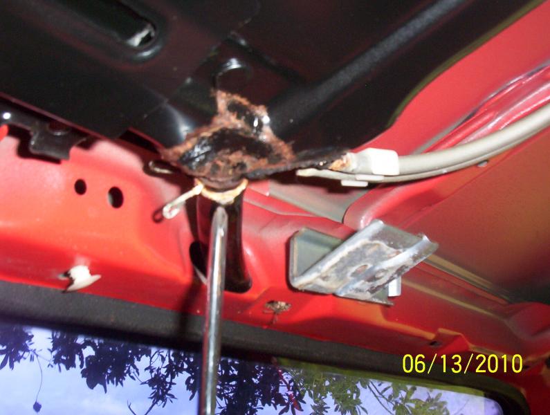

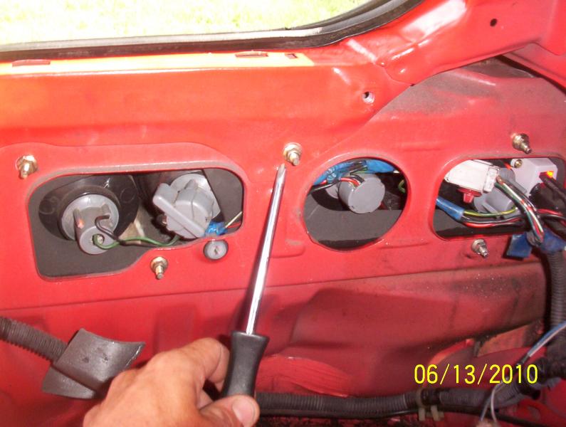

there are the hatch back bolts .check there. and everybody knows the tail lights leak like crazy . thats where alot of my water was leaking in.

i forgot to show where the top bumper bolts come thru. these are just a starting point . im sure other people can add some to this thread .

anyone know whare to get replacement tail light gaskets? mine are falling apart
Old Jun 13, 2010 | 11:12 PM
michael-crxsi's Avatar
Joined: Sep 2009
Posts: 633
From: TX
You can make them with the foam from a hobby store. I'm sure some one has a how to somewhere.

where the rear bumper bolts on. the top bolts come thru into the hatch area. another poss leak
