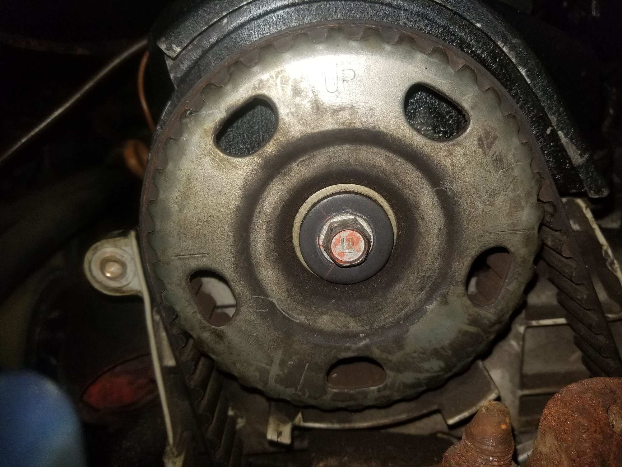

Timing photos. The lower pulley is lined up with the middle mark could not get good photo.
Lower pulley. Not camshaft pulley. Pointer lines up to middle line.
Camshaft pulley

Better photo
Better camshaft pulley photo
Another

For timing you should be using the single mark to the left of those 3. With that lined up the lines on cam pulley should line up flat where the head and valve cover meet up.

Okay thank you. So my timing is way off. Thank you will update with fix or no fix

It looks like both will be going the same direction, so it could still be on, but the horizontal lines on the cam gear should be perfect straight with the top of the head and the lower as I explained before. I would line up the bottom one and see how the cam gear looks.

All right i believe timing is set right this time. Here are some photos once again no start. Cranks over tho.
One line ndot the middle three lines on crankshaflt pulley
Lined up on camshaft pulley i think.

That timing looks good. What color is your spark if you can tell?
