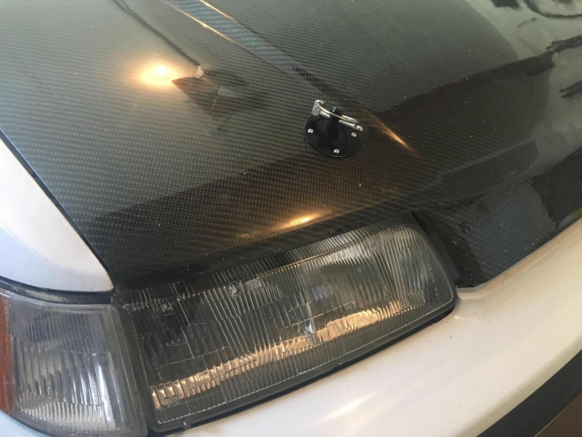

Also got the hood pins installed. They were a bitch to get lined up, and still aren’t perfectly symmetrical, but close enough.

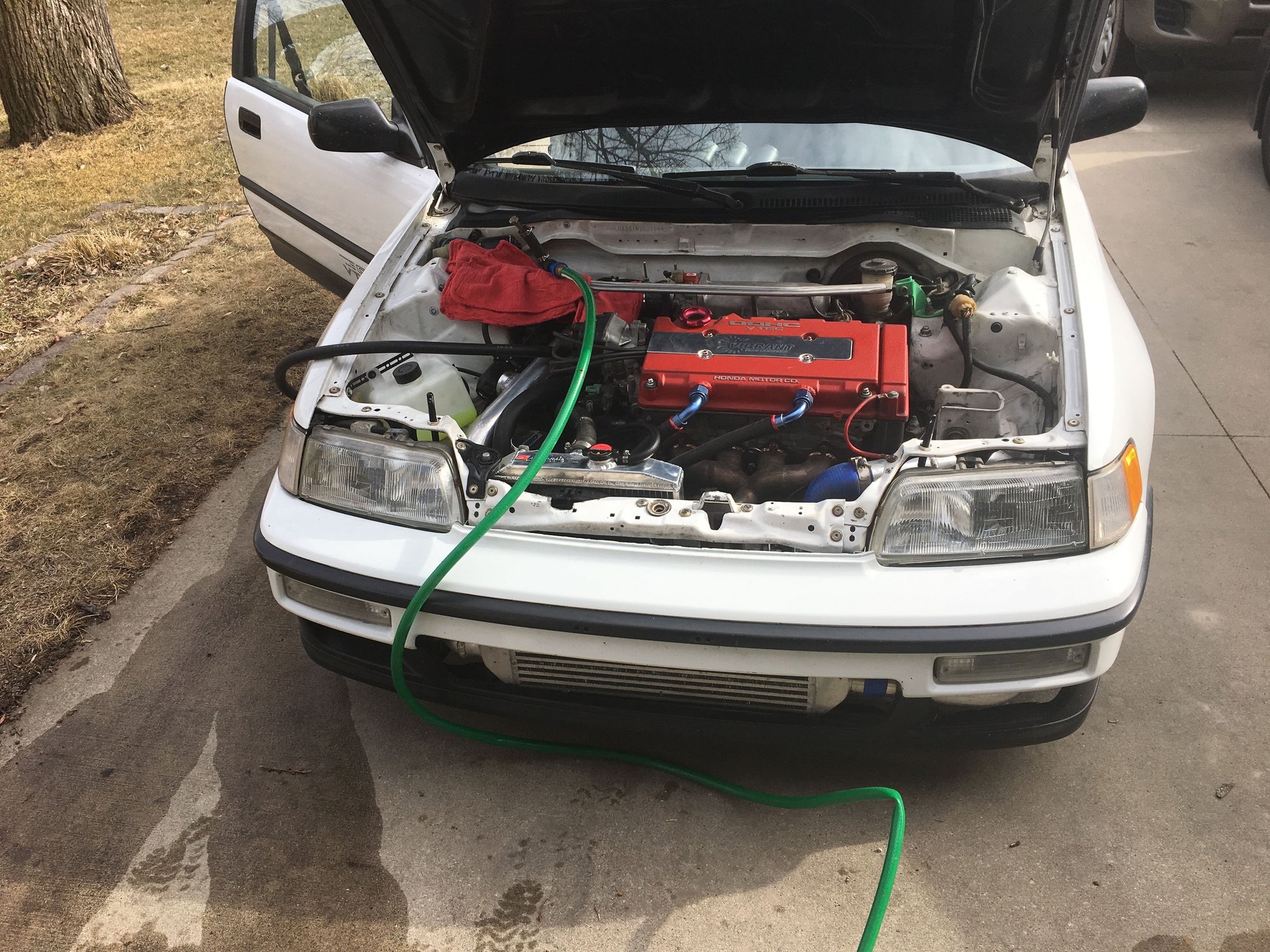

The crx has heat now. Today I flushed out the core to check for leaks, then hooked the hoses back up to it that had been looped.

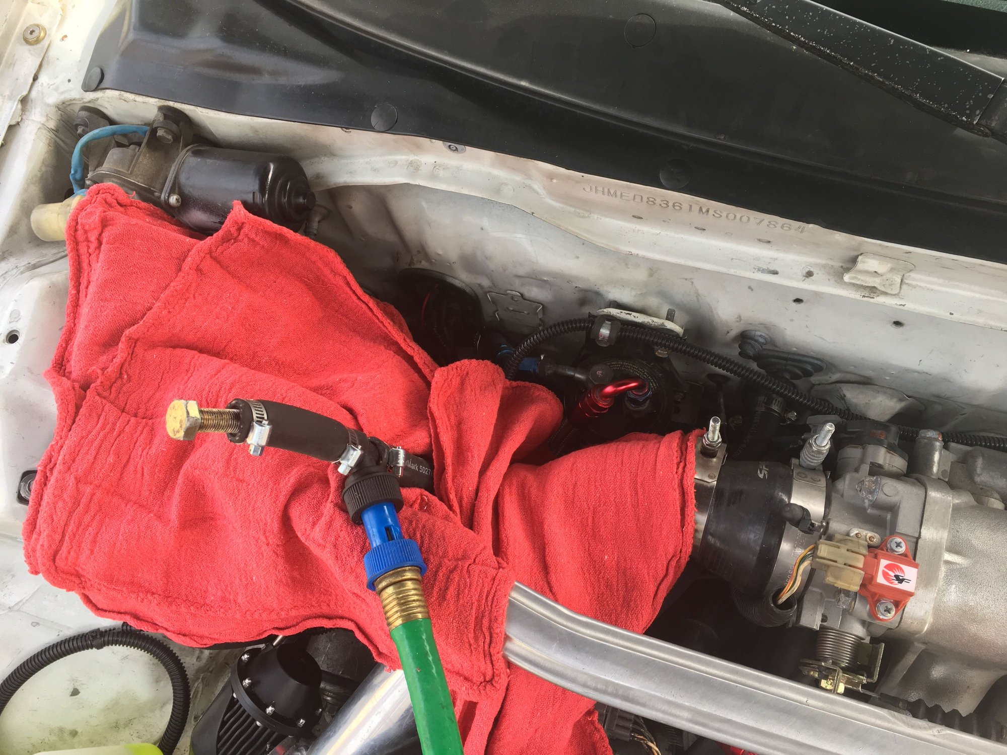

Here are some crappy pics of the process.
Garden hose hooked up and the black heater hose outlet onto driveway
Used this adapter kit from Autozone. The bolt plug was custom.
Surprised me that it still had green coolant in the core that came out at first.
Tried to protect electronics from potential leaks.
Flushed until water ran clear.
Made new hoses and hooked it up which was the biggest pain.
Overall the process plus burping the coolant system took me about an hour and a half. Heat works ok, not the best tho. Seems to be a problem with the blower fan.

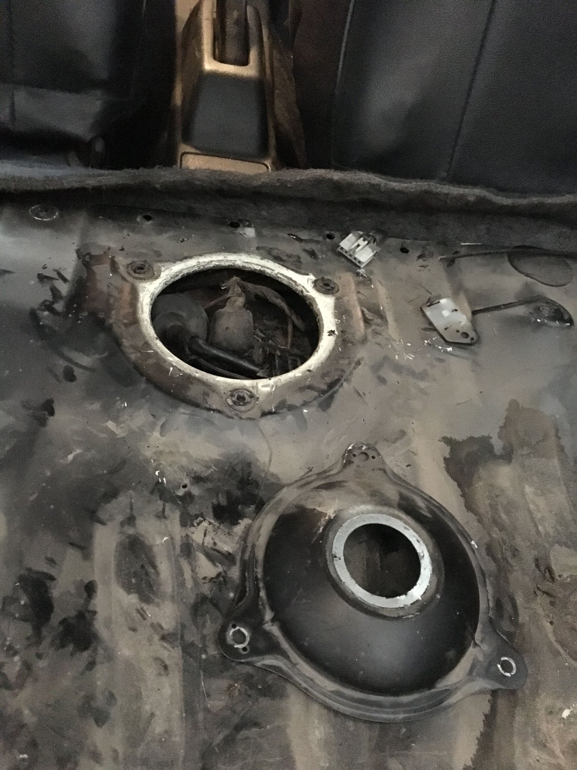

Almost forgot, I picked up this Airtex FS121 fuel strainer. From reading on the CRX forums, it seems to be a common problem that the universal strainers that come with Walbro pumps only access about half of the fuel tank capacity on HF’s. This is supposed to be one that will access all of the capacity.
Going to drop the tank and throw this in when I get a chance. I don’t really see how this will get me another 6 gallons...... but worth a shot

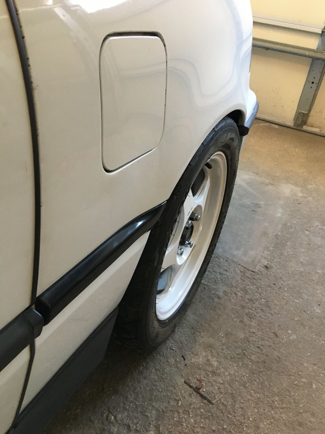

Here were the planned activities for today.
- Fix and replace broken and missing exhaust hangers
- Swap front tires/wheels to rear. Drive to see if vibration changes.
- Adjust rear camber to fit the 225’s
- Fix radio (wouldn’t turn on last time I drove)
- Drop fuel tank to install new fuel strainer
- Replace fuel line clamp under car that was loose (found this while I was under there today)
I didn’t get time to drive it to check the vibration yet. Also did not get around to dropping the tank. After watching the how to, decided I should run the fuel down in the tank and/or drain it before I drop it. Maybe next week.
The radio seems to just be broken. I checked for power and it’s getting 12V to the back, and the ground is good. So idk.
First I picked up a tuning laptop I found on CL for $30. Came with a docking station, charger, and a bag. The only issue is it sometimes has a fan error I guess. Seems like it was a steal though.

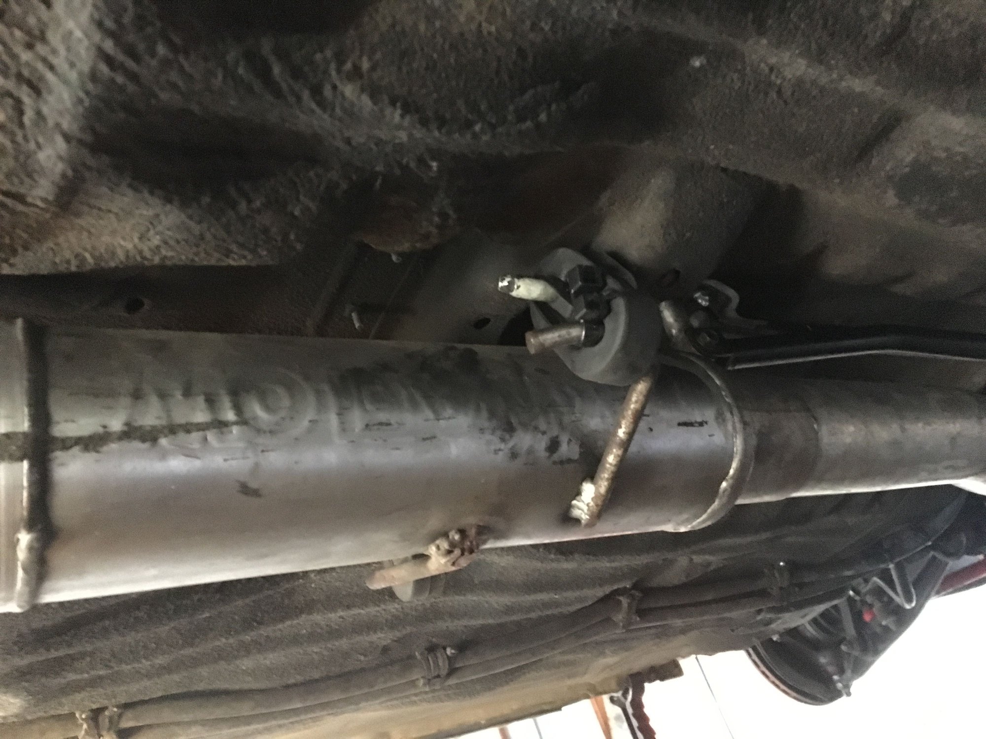

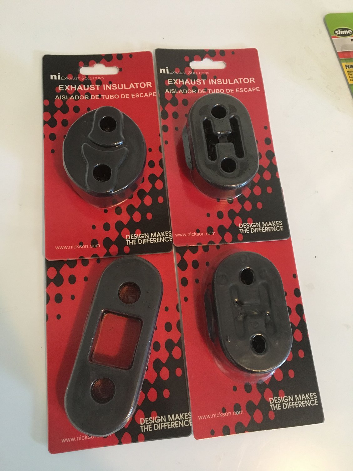

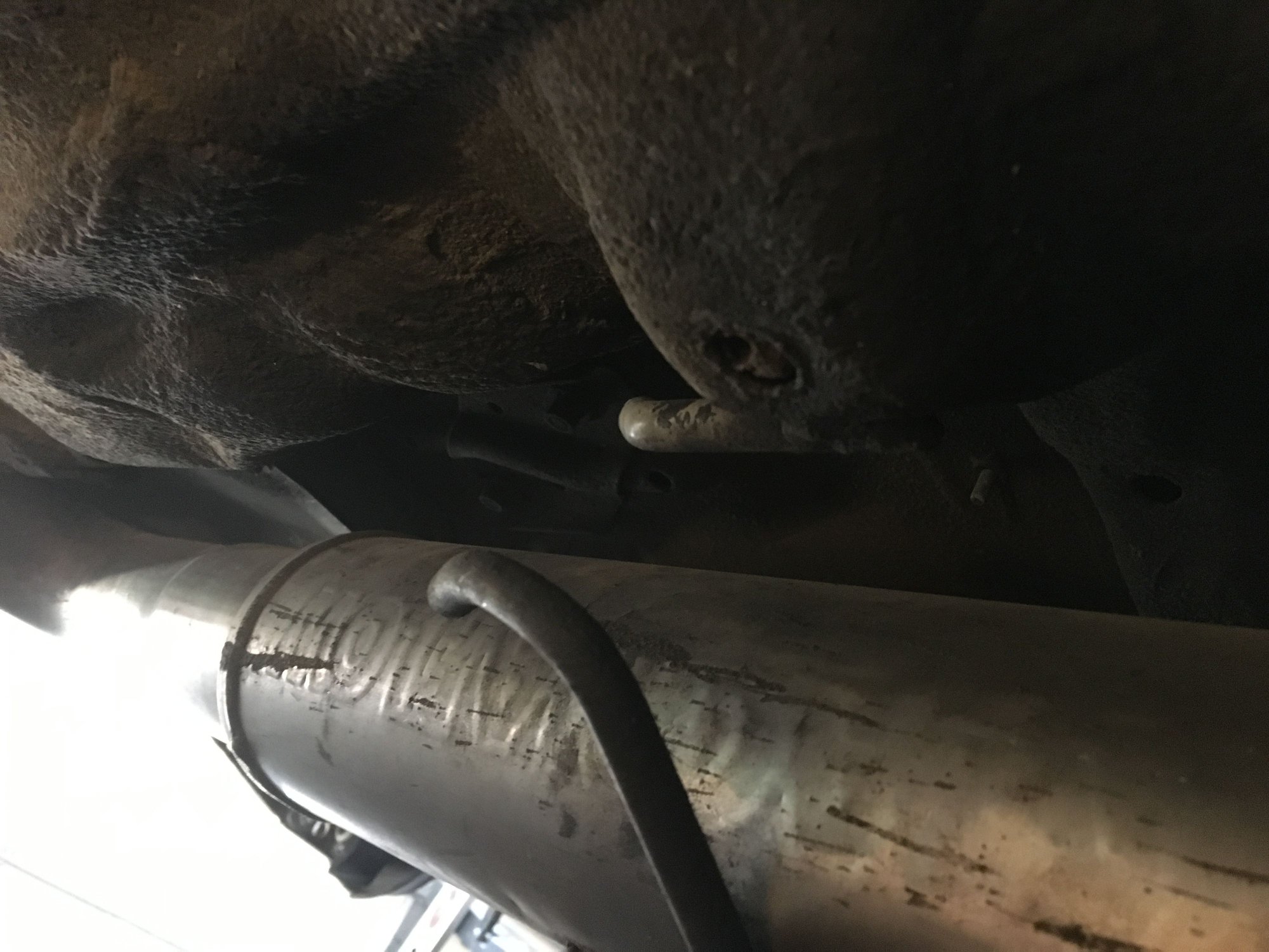

Then I ran to autozone for some various exhaust hangers. I noticed earlier that my rear one over the axle was all stretched out. Then today I found one under the car missing entirely.
Got the car up on jackstands and took care of those first, along with the hanging fuel line.
Next was to tackle the rear camber and swap the wheels around. I was in for a real treat there. Previous owner had the. Camber arms installed wrong, one side had an end flipped 180 from the other. I didn’t have the right size wrenches to break loose the seized nuts either, so there was a second trip to autozone...
Passenger side
Drivers side. Notice how the inner joint was flipped.
Had to pick up some supplies to continue with the job...
This is how they were before I corrected them.
And the final fitment.
I took some time to inspect the suspension and look for any work bushings or parts that need replaced. To my surprise, the RTA bushings have already been done.
Should be driving next week it the weather cooperates and it gets above the 20’s like its supposed to

The plan today was to pull the gas tank and be ready to put in the new pump and strainer once the pump arrives. Then once I got that far I was going to start on my valve lash adjustment.
The tank came out pretty easy, entire process took maybe an hour which is not bad for my first time, plus I had to drain the half tank that was left in it first.
I got really pissed after though because my new fuel strainer disappeared! I spent an hour looking everywhere for it, so I wasn’t able to get into the valve adjustment today. I guess I’ll be ordering a new one.
Pulled out the interior bits to get at the sending unit, remove the cover and disconnect the wires.
Drained the few extra gallons that I could to reduce the weight of the tank. I couldn’t burn any more with the old Walbro strainer not reaching the bottom of the tank.
Lowered it down and disconnected the e85 fuel lines they had installed. This is after disconnecting the fill hose, breather, and ground wire for the pump.
As it sits now

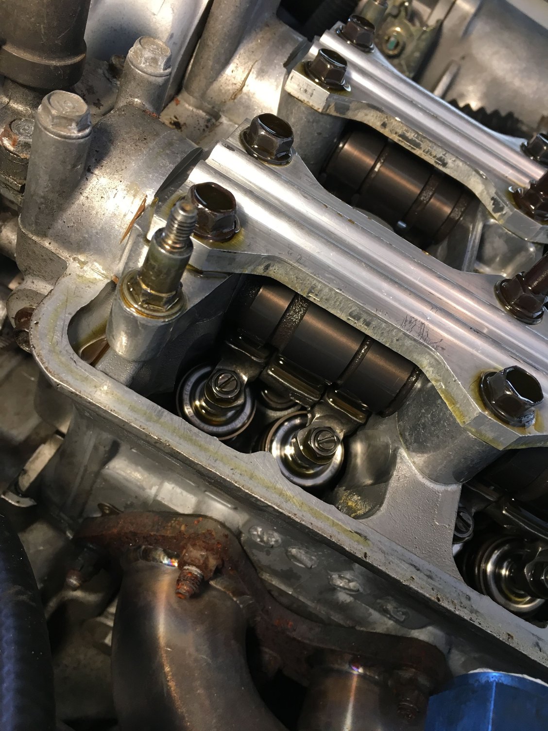

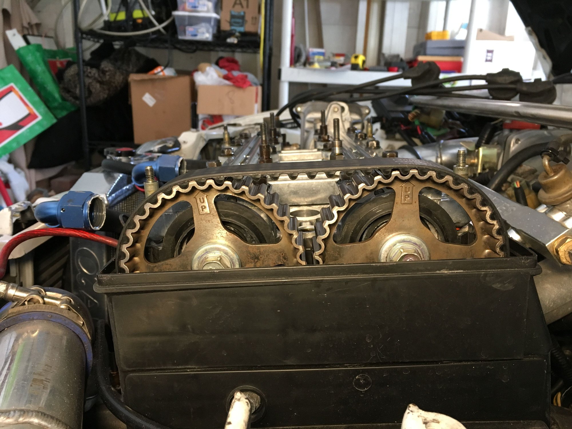

Noticed that the cam gears don’t seem to be aligned perfectly. Trying to figure out whats up with that.

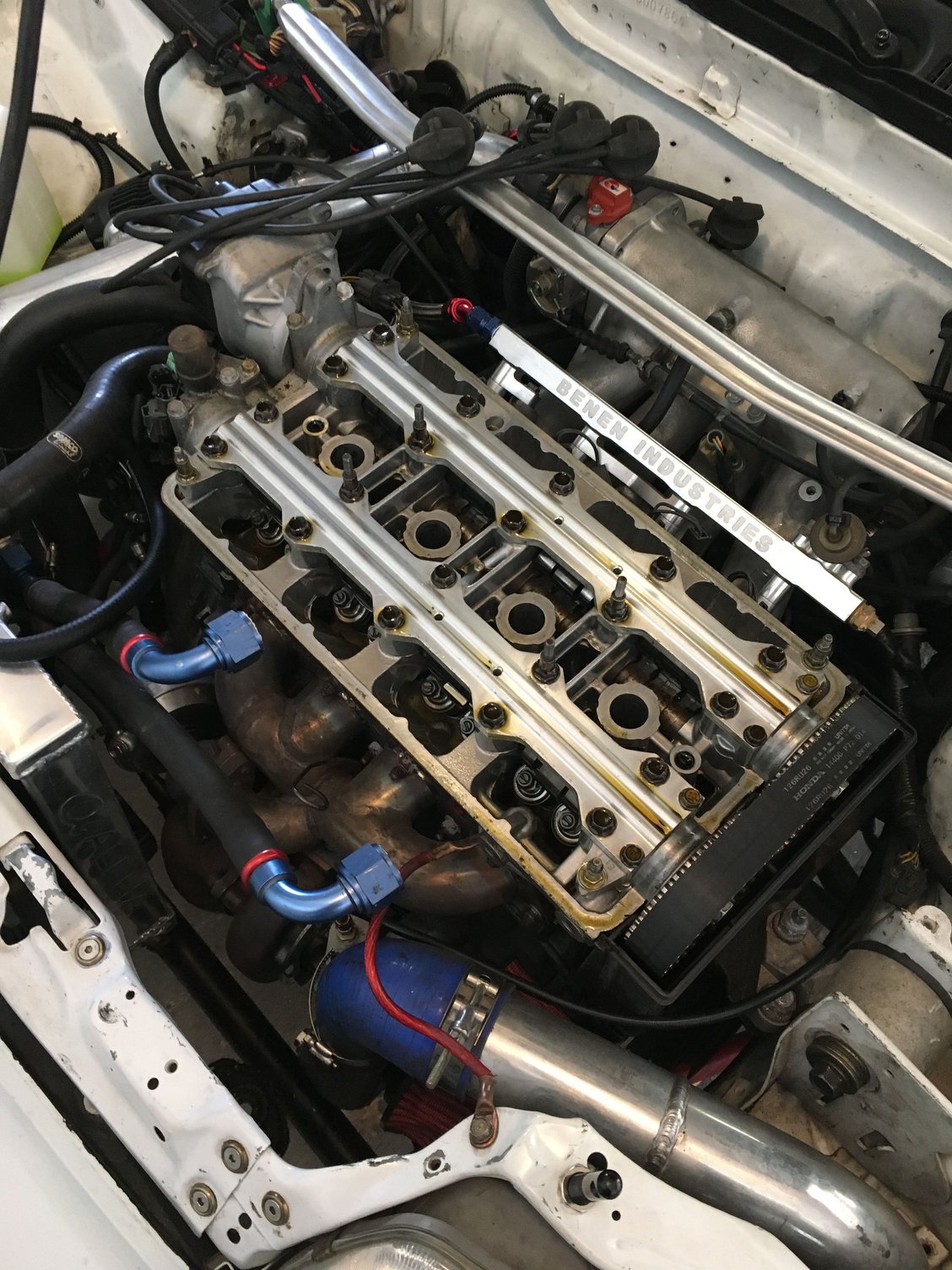

Everything inside looked nice and clean.
Got half way done with the valve adjustment. Some were too tight, and some too loose on the intake side. Going to finish up the exhaust cam later.
