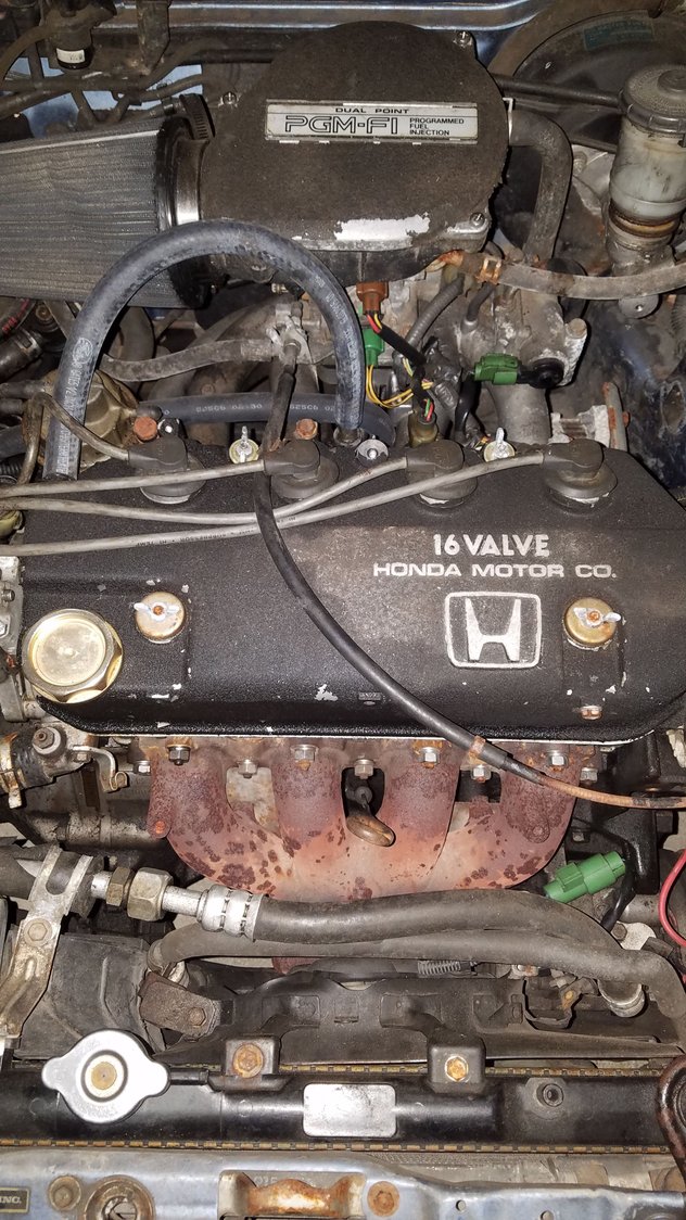

Alright guys... So I hope I'm in the right section here. I recently got this car and have some really rookie-a$$ questions. New to the Honda scene, so bear with me here.
So, I'm trying to figure out what motor I have here. Block says D15B. Has the Non-Vtec motor with the plugs closest to firewall, and the offset Honda Emblem.
From varying sources I've been told D15b Non-Vtec JDM motor, D15b7, and a few others. So what am I working with, and what is my factory power output?
Also, what is the funky thing on the back of the head where Vtec typically is in pic #2? Resembles an Egr, but I was under the impression it would not be located here? Although, the capper vaccum limes scream Egr to me... Like I said, Honda Rookie here... help me out fellas!

the engine you have is an OBD0 JDM D15B which was originally the dual carb model D15B that some one removed the dual carbs from and installed the DPFI intake from a D15B1 or D15B2 onto it - the thing on the back of the head is the mechanical fuel pump used on the carb engine, which is actuated by the camshaft - most people remove the pump and fabricate a flat block-off plate which is then bolted to the head - the dual carb D15B was rated at about 100hp with the carbs, probably a little less with the DPFI - likely would be the same as a D15B2

Thanks jlicrx, I knew someone would chime in! Looks like they've been in the top of the motor recently. Head is super clean with new intake/exhaust studs. I guess I need to pull that pump and make a block-off.
