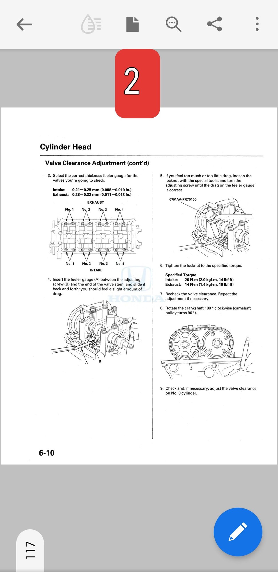

Your method sounds correct. Sort of a go no go method.

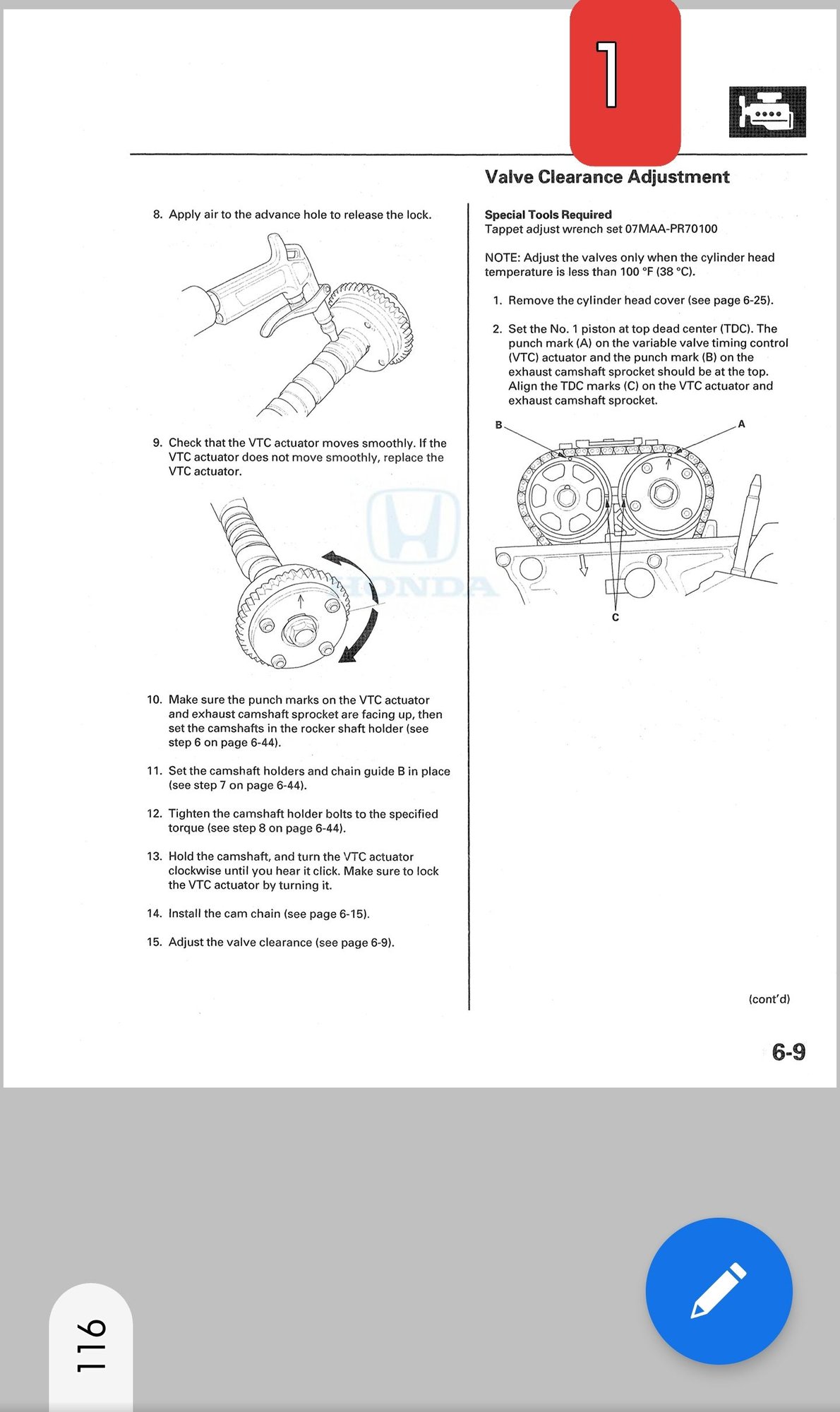

Your ok. Sounds like you did it right.
8 to 10 thou' for intake and 11 to 13 thou' for exhaust.
Heres the procedure for future reference and anybody else doing this job.
