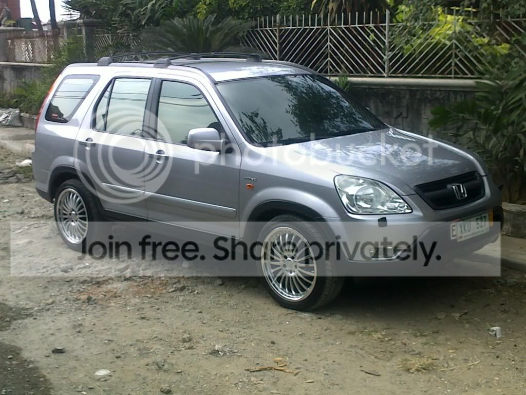

i gotta 02 V...k24a1 ftw its safe to use the skunk 2 ep3 springs($170)...they're not as stiff in the back so your wheel will be in wheel well but it'll level out the car..obx exhaust($20) deffinitly freed up the air flow by alot. i couldnt find a actually CAI so i make one out of some 3" exhaust piping and a spectre airfilter($20)
