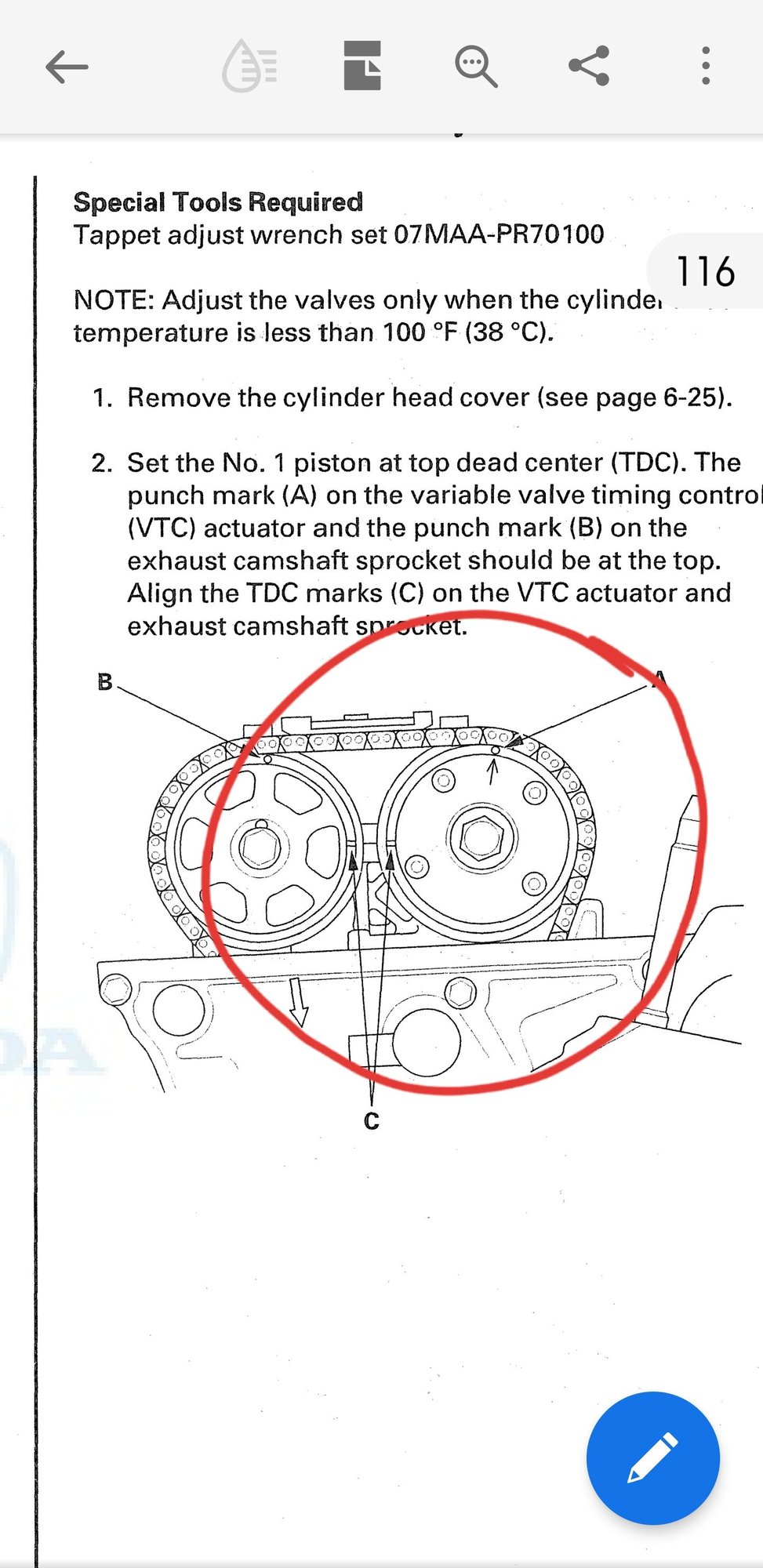

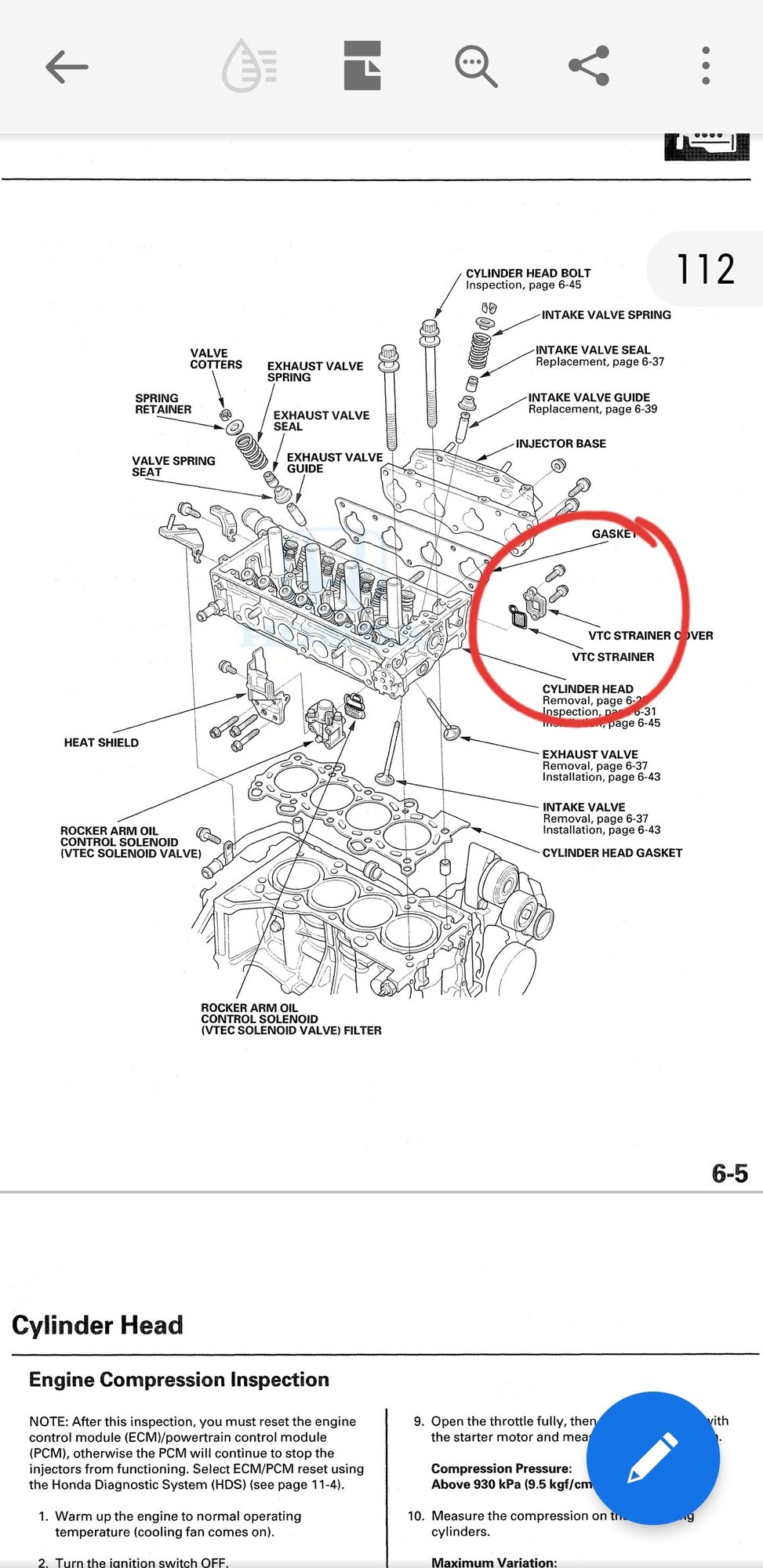

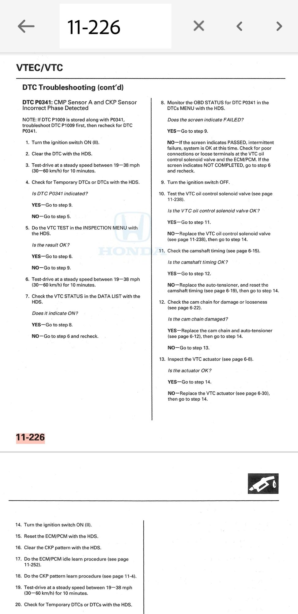

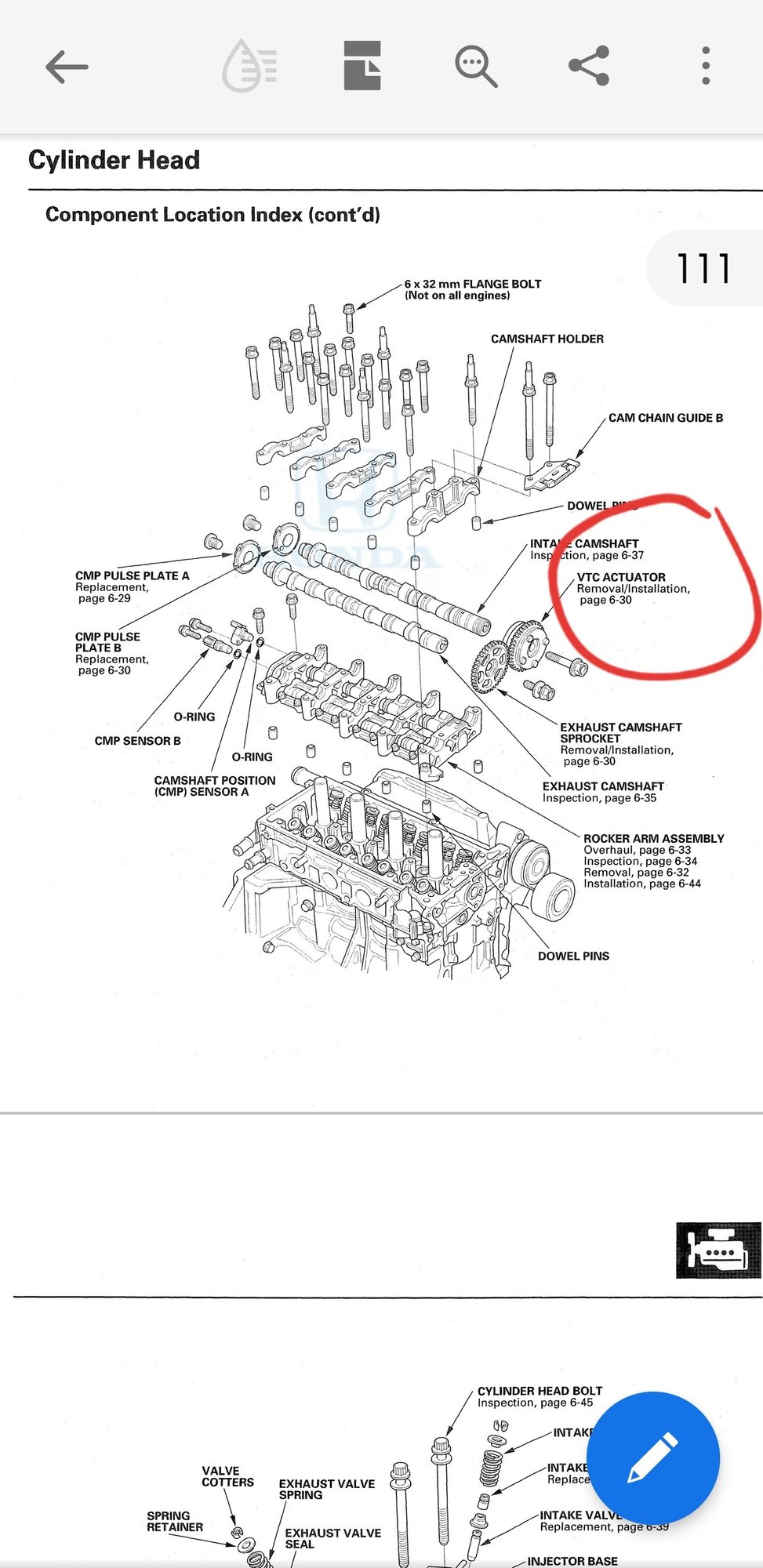

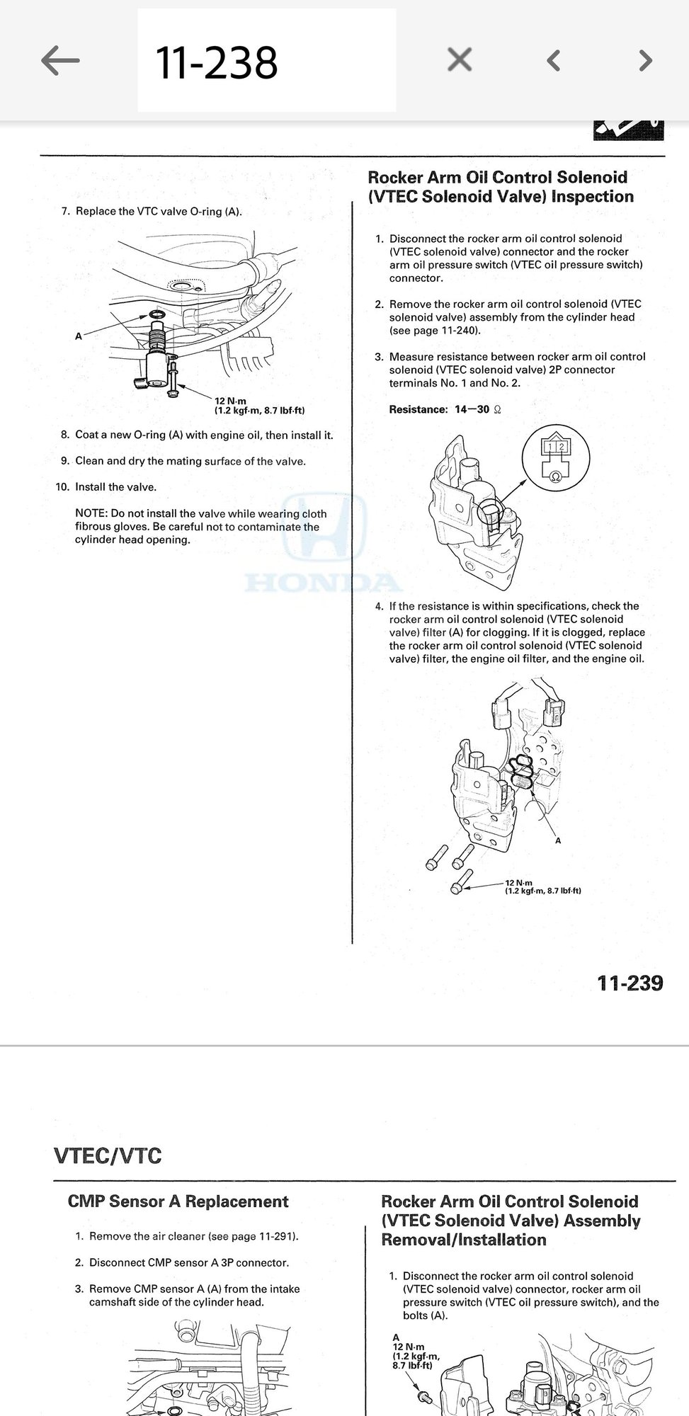

PO341 is for your camshaft and crankshaft being out of sync...in this case Sensor A which is Intake Cam out of phase with crankshaft. A failed Intake (A) is PO340. There's no Bank 1, Bank 1 is for something they would say for an oxygen sensor bank 1. Before you start jumping on the timing chain there's a few things that you should check. What could take things out of sync is if the camshaft VTC which is your Variable Timing for the intake Camshaft is inoperative. The variable timing of the camshaft is controlled by oil pressure. There's an oil pressure solenoid that will actuate the device.. there is a procedure to check the solenoid which I will include in the attachments. This should be done first. There is also a procedure to check the VTC actuator; it involves removal of the intake cam and dismantling the timing chain cover etc. If those check out and you confirm all of the connections at the terminals are solid for the solenoids and the sensors then the next step would be to have a look at the timing chain. Now you didn't say how many kilometres or miles are on this vehicle and generally the timing chains last the lifetime of the vehicle however they will "stretch" a nominal amount due to wear. There is an auto tensioner involved in this whole setup and assuming that it's functioning properly the timing chain slack shouldn't be an issue however if the tensioner has failed then you'll have excessive slop in the chain which could throw the cam timing out. If the tensioner fails and the chain is loose it can actually cause the camshafts to skip and a no start/bent valves issue happens. I would go after the VTC and verify its operation first. Clean engine oil is critical in these engines as any excess contaminants will cause the screens in the solenoids and the VTC actuator to get plugged up and malfunction
This is what the Intake cam should look like at rest with the Crankshaft at TDC of the ignition stroke. Notice the 2 timing marks AND the VTC arrow and dot lining up.
DTC troubleshoot chart PO341 Incorrect phase detected

Good luck but check the VTC solenoid and the VTC oil strainer screen first. Start at the easy stuff!
