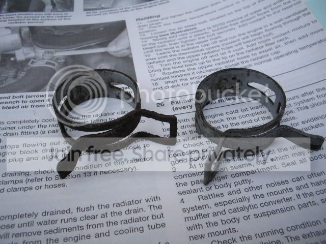

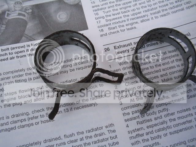

i think these clamps are still good. what do you guys think, get new clamps?
Old 07-13-2004, 01:38 PM
civicminded92's Avatar
Join Date: Nov 2002
Location: Northeast, Bama, Yall
Posts: 294
Default Re: where is the drain plug for the coolant? """d16z6""" (frostcivic)
A little nasty, but yeah they should work. If you have a leak, get new ones.

if i have to replace them then i have to drain and refill the system again, right?
maybe it's wise if i just get new ones.
Old 07-13-2004, 01:47 PM
Join Date: Nov 2002
Posts: 294
True dat for the lower hose clamps.
If it were me, I'd use the best looking one on the bottom and the others on top. Wouldn't have to drain entire system for the top ones, but it might be a little messy.
Heck, they're cheap enough. Get new.
