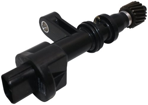

When I check the sensor, it look like this:
It is the Accord sensor?
I check in the net with the P\N 78410s04911 and the sensor is difrent.
Like this:
What i buy?
Can you help me pls?
Thanks

What's wrong with your VSS?

The middle pin whitch connects the plug to the sensor is broken.

Your VSS looks like one from a U.S./Canada 92-95 Civic rather than a 96-00 Civic:
92-95:
96-00:

Thanks for your Help.
Probably the gearbox is the model 95-95.
The speed sensor it's the same for the D14,D15 engines to the B16A2?
