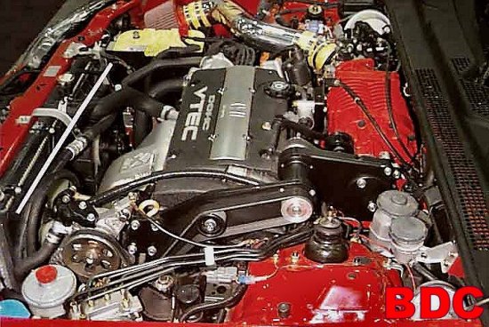

Here you go n00b. Take a look and figure it out for yourself:

BTW, anyone wanna tell him why it won't work???

...the intake manifold is already reallly close to the firewall...
Hint: Got nothing to do with the firewall...

would it be that big *** pulley thing =P feed me the TRUTH BDC! hey wheres the guy who wanted to know?

would it be that big *** pulley thing =P feed me the TRUTH BDC!...
BINGO! What's the obligatory comment everyone always makes about the H22A CiViC? "How the fu*k are you going to change the timing belt; take the motor out of the car?"
As you can see from the Lude pic, they had a hell of a time getting the drive belt back to the SC.
In a CiViC, this would be impossible, as there is almost zero clearance between the timing cover/bottom pulley, and the driver-side strut tower. Here's a couple of pix illustrating the point:
Good eye, my man!!!
