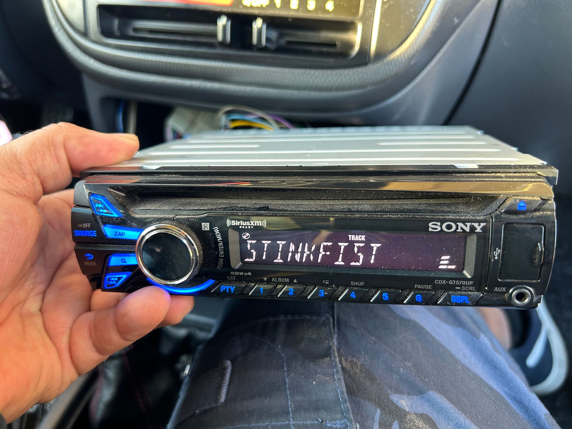

So 3 weeks ago when I got in my 97 ex the stereo (aftermarket) didn’t power up, few hours later when I git home and tested the 3 fuses, first under the dash (it was good) the one under the hood (also good) and finally the one behind the sony deck (also working) I figured that after 6-7ish years of being in the car the deck was finally done for so I ordered a new one. It came in last week so I wired it up using a new radio harness plugged it in and still nothing. I also have a 98 hatch so I decided to test both decks (me thinking that maybe the old one still worked and the problem was with the actual car) so I plugged in the old deck and it definitely still works (first pic)

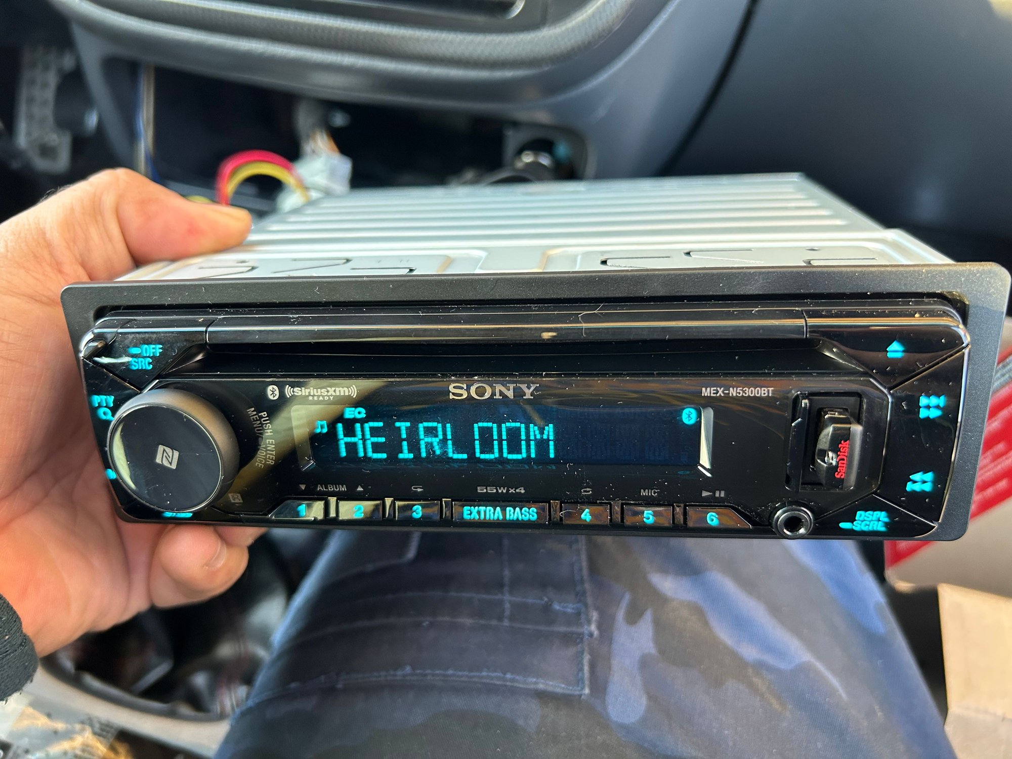

I then plugged in the new one and it also worked without any problems (second pic)

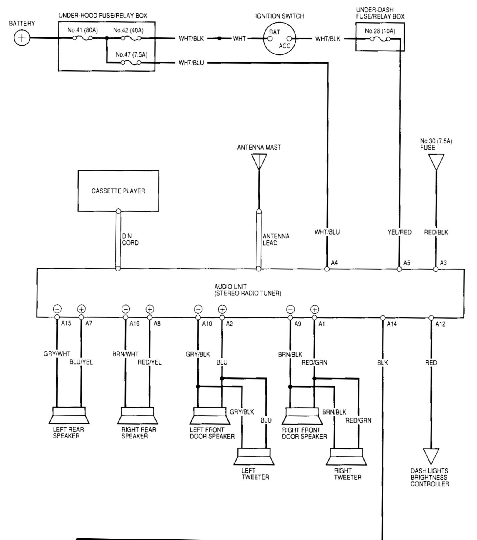

That YEL wire is the 12V constant wire.
You need power there at all times even with the ignition switch in OFF position.
Here is the circuit diagram for the EK
No.47 (7.5A) Fuse under the hood should be your constant wire power (WHT/BLU)
