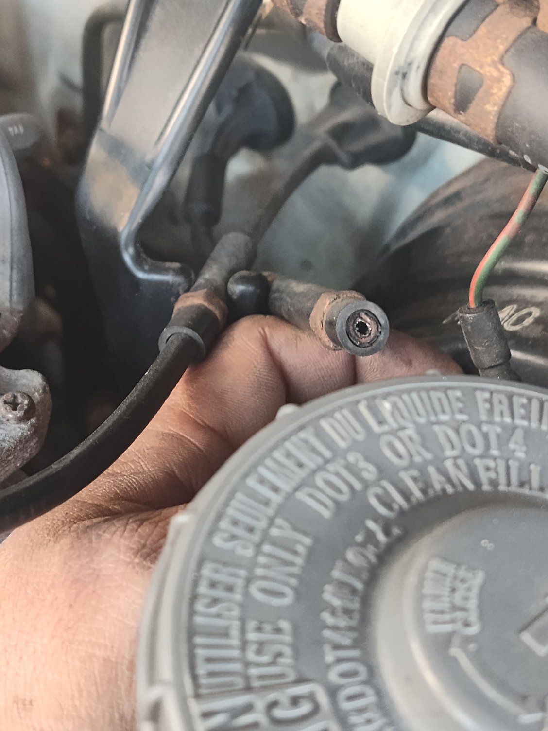

Is this not a speedometer cable. It goes into the firewall.
Also what goes here (2nd photo) what goes on/into the tube that's pictured under the hose?

Pic one is a chopped off cable that should have gone to the Cruise Control module normally bolted to the left side wheel house just ahead of the shock tower. The lower pic shows the vent tube for the transmission case. There is normally a rubber vent cap on top that has a small 90' elbow pointed horizontally to keep crap out of the inside of the transmission.
The VSS (Vehicle Speed Sensor) is found on the rear differential area of the transmission case... found below the shifter cables and directly below the bottom of the throttle body. There is a 3-wire grey plug connected to it as well as a pair of power steering lines.

That makes sense that it's the cruise control cable because I do not have the cruise control module. I guess I'm going to have to try to track down if there's a fault in the wiring for the electrical connector to the VSS. I tested it and it's getting 12 volts as well as ground but it's still not working apparently. You think it could be that I need a new instrument cluster?
