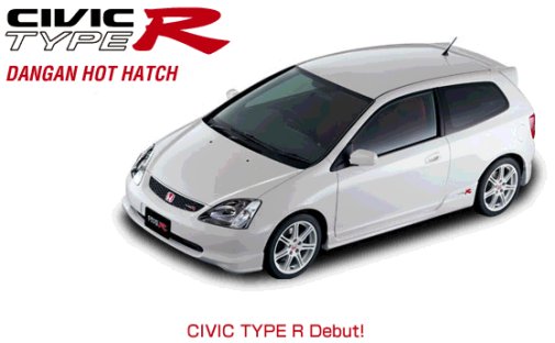

When you said there wasn't any difference, I wasn't thinking about parking or DDR memory. I was thinking about the difference between that POS 2002 Si they gave us, and the Type R they kept for themselves. That's the kind of stuff I was talking about.
Example:
Honda civic type R
What you are looking at is something not even remotely available here in the United States unless you can pay Japan to send you one, then convert it. If you live in Japan, or maybe in South America, you are lucky, because you are the only ones getting these cars here on this page.
The Civic Type R is a Japan-only automobile. You can bring it to our shores at some cost, but it's not made here nor can you just go to the dealer and pick it out. It has been said to be an even crazier experience to drive than the Integra Type R. Super Street, it is said that the Civic Type R makes the ITR seem civilized. It seems pretty hard to believe, but Honda does put out some crazy cars. If you live here in the U.S., I'm sorry, I hope it doesn't bring tears to your eyes that you nor I can test drive this at your Honda dealership. Maybe if enough of us tell Honda to bring it here, we can change that.
All joking aside, which has the better motor; the JDM or the USDM? No difference?
