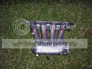

Your stock mounts should be perfectly fine with that setup... If anything you could try the motor mount inserts (you dont need them) ... They're cheap and make your current mounts a little stiffer, it helps keep the engine from moving, but is not as drastic (vibration and price wise) as the full mounts.
BTW some more things to do to your setup to maximize power would be a bigger throttle body (port matched to the IM), smoothen the manifold inside, get an aem IM gasket to insulate your IM from the block, match the runners to the block.

Re: point of motor mounts? (EVIL Hx Coupe)
I see, thanks alot!
EDIT: I guess increasing air flow from the TB to the ported IM is balancing the increase of fuel. Correct me if I am wrong but in order to have results increasing the size of the fuel pump, I need to increase air flow by boring the TB and port matching to the IM?
EDIT: this thread has been hijacked.

Re: point of motor mounts? (dchan86)
<TABLE WIDTH="90%" CELLSPACING=0 CELLPADDING=0 ALIGN=CENTER><TR><TD>Quote, originally posted by dchan86 »</TD></TR><TR><TD CLASS="quote">I see, thanks alot!
EDIT: this thread has been hijacked.</TD></TR></TABLE>
It'll just help you get as much air in there as possible, when everything is nicely matched up and polished there's less resistance and no obstruction for the air.
For example: Whats the point of having a 70mm TB if your IM opening is only 60mm??? see what im saying?
