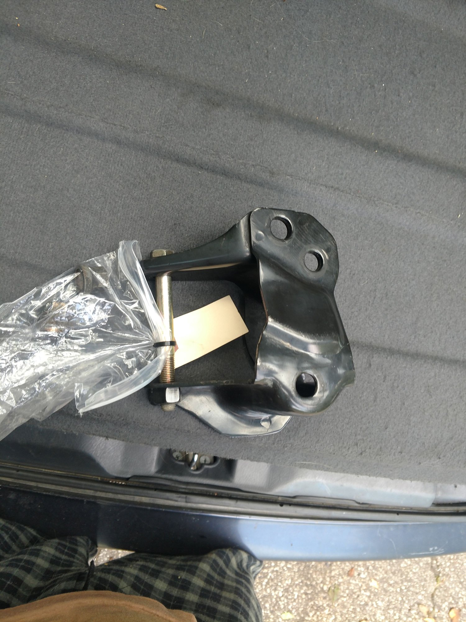

1320 motor mounts came!
HIGHLY impressed. Heavy weight, 65a polyurethane, billet aluminum, NO visible flaws, and extremely well made... Far exceeded my expectations. They cost 150 from ebay- didn't want to cheap out, but couldn't afford hasports and I bet these are exactly the same.
Comes in either 3 post or 2 post- same price. Comes with bolts and bracket too.
2 post:
Http://m.ebay.com/itm/1320-Performan...-/282338904898
3 post: 1320 Performance B & D series motor mount 3 bolt driver side billet aluminum EK | eBay

not the exact same as hasport. those are counterfeit hasport mounts from china. they just happen to have 1320 engraved on them.
remember the old saying you get what you pay for. well that holds true in this sense.
