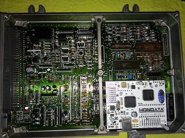

I got my wideband wired up. D10, A25, and A26. I don't have clippers small enough to cut R136 and R138 out of the ECU so I didn't test it out. I'll get a pair tomorrow.

And now for the pictures.
ECU and Wideband Stuff
