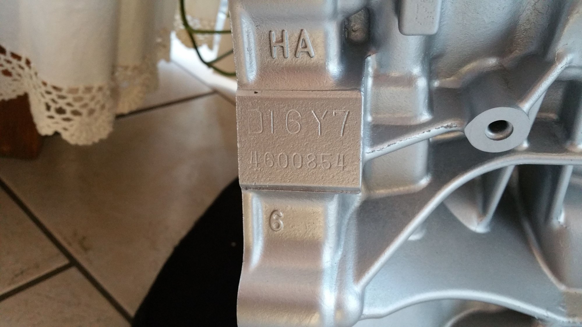

Car:
1996 Honda Civic EX, Automatic
(Original engine block D16Y8, which died, last owner replaced it with a D16Y7..)
Ok well I aquired the vehicle with a few issues, even though the car did turn on, it sounded terrible(Like a knocking in the engine), and it wouldn't pass a certain rpm. I recently took the engine out and started a rebuilt, at first everything seemed fine, good rod bearings and most of the main bearings were good aswell, except for 2 main bearings which were totally worn to the copper, not to mention they were smaller in overall size aswell..
Now I have the engine ready to go and we'll I have a few questions:
1- I was told that my setup will be almost stock and not a "mini me" since the Y7 and Y8 blocks are the same, except for pistons and the knock sensor. My Y7 DOES have a knock sensor, I'm just using the Y7 pistons, will there be a problem?
2- Again I was told about the IACV and that my intake manifold didn't have the holes to put it... I'm using the original manifold that came with the car... what...I'm confused.?
Basically all stock EX parts from my car all Y8, basically the only thing changing here is the block to a Y7 (knock sensor included)
I'm posting pics so you guys can see if I'm missing something, or if there's an issue
Oh and p.s. I'm using the original Y8 ECU.
Thanks!, help will be highly apreciated!!

Re: Mini Me Build questions.. is it a mini me??
The head looks like it has the B7 cam gear for the 6th gen 5th gen minime.
Need to get the Y8 cam gear if you are going back to the 6th gen block or you will be 1/2 a tooth off on your mechanical timing.
The transmission might have a VIN stamp on the front of it, that would make it easy - it should start with 1HGEJ8. The important part there is EJ8. If it says EJ6, it's the wrong transmission. Aside from that, start looking for identifying stamps anywhere on it.
For the head, just like NARC stated for the transmission (and likely cluing you in to the head too) look for the casting stamps. You can verify if it's a Z6 or a Y8 head from the castings stamps.
Yeah the IACV is located in the Throttle body i'dk why they told me I needed one in the IM, since I knew my IACV wouldn't cause me problems, my original Y8 wire harness has the right connector. There just trying to get me confused so I had to ask
Well I checked the head and transmision and found verry little:
*Stamps found on head
-606060777
-129070
-96 (I'm guessing year? Which matches my cars year)
-P2J-5(a bit of Google, and it looks like it is an EX Y8 head)
*Stamps found on transmision (not a lot)
-P4R•2-1
-P4R #1
-6AN1092
-C051BC
-A4RA-50???? (This one was a bar code sticker located under the top transmision mount braket, unfortunately it was in bad shape and couldn't read the rest of the top code, bottom code is TP2R60,
A bit of research, an automatic transmision does come up, but can't verify if it's a vtec.)
Now, is the Y8 transmision really nedded? Or is it only to give the vtec it's full potencial? I'm sure its the Y8 there were no signs of trani removal, like the engine.
Thanks!
So yes, you have an EX head. It could also be an HX head, but I highly doubt it. If you want to be 100% sure, just pull the valve cover and look at the rockers. They should not be roller rockers.
I'm not a genius on autotragic transmission codes so someone please correct me if I'm wrong, but I believe P4R is the DX transmission. That won't work. You have to use an EX transmission if you want to stay automatic. Long story short, the TCU is integrated into the ECU, and if you tell an EX TCU to control a DX transmission, it gets angry.
Sadly there is no Vin number on the tranny, paid a visit to my local scrap jard and to my luck they had a D16Y8 (vtec) engine and transmision, the guy was asking $1200 even though he told me the engine had issues since metal shavings were found in the oil and would take my freshly rebuilt Y7 for $150 off... really ..... so it's not worth it. Took a closer look at the transmision and yet again no Vin number, only "B4RA" when mine is a "A4RA" a bit of Google research and turns out that BOTH transmisions are honda transmisions but can't verify for what model... the transmision they had was identical to mine, same connectors etc, and if I was interested to let them know and they would remove it for me..
I'm soooooo confused atm guys no joke, I seriously feel like a huge noob.
So to get things straight... the engine and head should be fine, all I need is a correct cam gear for the head right? And tranny IF it's not the right one correct...?
ATM I feel like getting rid of the hole car for a reasonable price..
Thanks!!
I never narc'd on nobody!
$1200 for an EX engine and transmission? :l mao::lma o: :l mao:
I want whatever he's smoking!
Yes, the engine and head should be fine. Yes, it looks like you need the correct cam gear. 14211-P2E-003 is the OEM part number, it's all of $27 new. Yes, you'll need to get the correct automatic transmission if that one isn't. On the plus side, the axles and everything are the same, so if there really isn't any way of telling, you could just install the transmission, give it some fluid, and see what happens. It's kind of a shitty answer, but unless someone chimes in with a good way to identify your transmission, it's all I can think of
You should be fine on the transmission. I'd wager 100 to 1 that it's the right one, given the circumstances. As for the cam gear, any stock 96-00 Civic (non-SI) or Del Sol S or SI will hae the correct cam gear for you. Granted, if you find a 99-00 SI, or a Del Sol VTEC in the junk yard...uh, don't worry about it, just tell me what junk yard you found it in
To replace the cam gear, you'll have to remove the timing belt, so I wouldn't even bother installing everything with the wrong gear in there. You're just gonna have to do it all a second time if you do.
