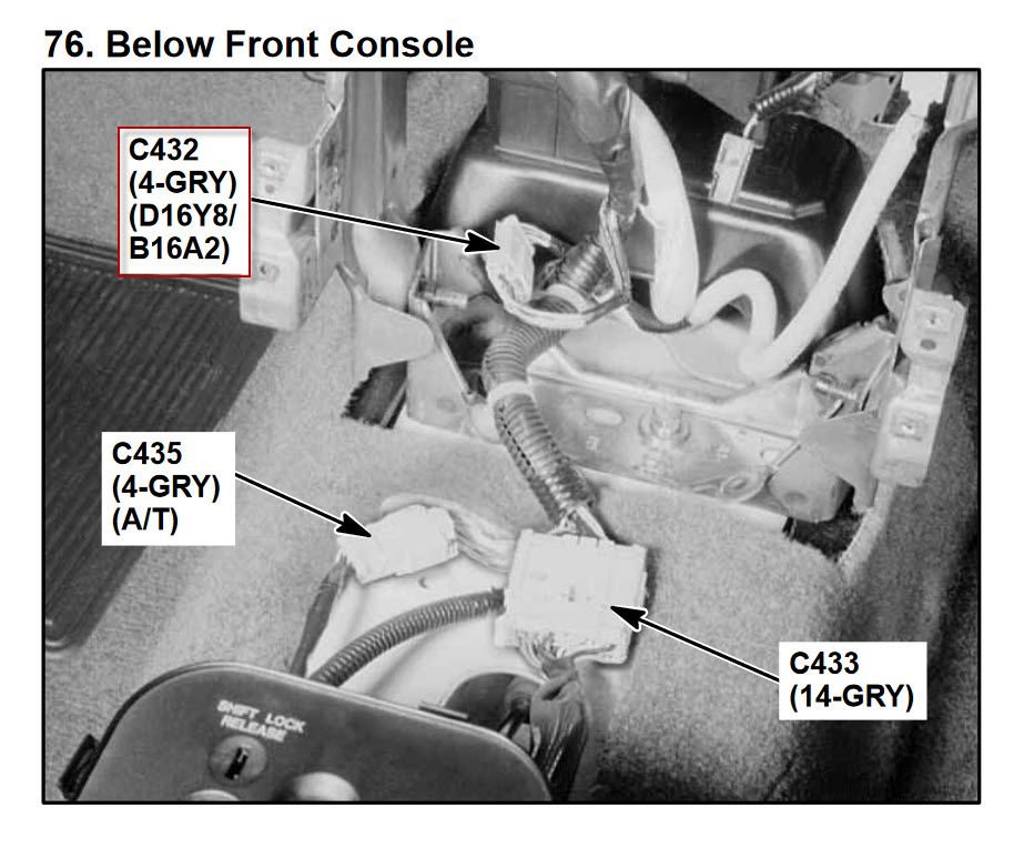

The em1 secondary 02 connects at the cabin harness. It has a little short sub connector. It should be under your center console.
this what's under the centre console should it be there or is it missing from it. Thanks

Default Re: Lambda sensor plug em1
On North American models, it is a grey connector C432 as shown. Your country code shows Ireland, so configurations may be different.
Is it like a grey flat 4 pin plug
Yes.
