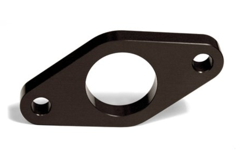

Well something to keep in mind that isn't pictured on mine is that unless you modify the shaft on the S2K cmc you will need a spacer to get the proper pedal travel. I don't *think* my m/c is actually bad, but since my clutch action is so **** right now with the failing T.O bearing I'm having new clutch hydraulics on hand just in case. The spacer looks like this:
...and I ordered one from Amazon
HERE HERE
so I won't need to modify the new one I bought, if I end up using it. If I don't use the new m/c then I'll return it to Honda, and return the spacer.
