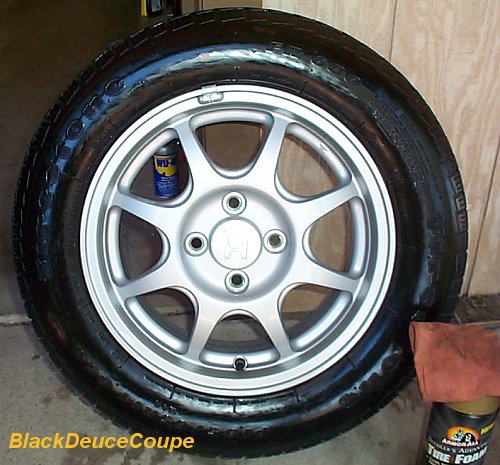

What size tires do you guys run? I'm using OE-size Yoko YK-420s [AVID T4] and love them to death too, but I might try the Azenis next...

the hx wheel is extremley light and is made by enkei.
Learn something new everyday
Yep, here's proof...

Hey BDC:
You like the Yoko AVID T4? Really?
Well then I think you'd crap in your pants once you got the Azenis.
Why?
Well right now you're rolling on 185/65/15 T-speed rated Yokos. These tires have a 420 treadwear and a really flimsy sidewall. They are really more of a passnger tire and are not intended for performance use.
Here's the Yoko:
And then there's the Falken Azenis. These are a 195/60/14 so they are about the same size as the Yoko since they are wider but not as tall. These tires have an H-speed rating and a much stiffer sidewall. I have mounted a few sets of these at the shop I work at and they are the stiffest 14'' tire I've felt besides of course R-compound tires. They have a 200 treadwear and they are super sticky. I have the Azenis on my 15'' wheels in the 205/50/15 variety and they are THE ****.
The Falken Azenis:
Comparing the tires in terms of sheer performance isn't really fair. The Azenis are probably THE most popular street tire in SCCA and they are reknown for their grip.
Don't think about it, just buy some Azenis damn it!
